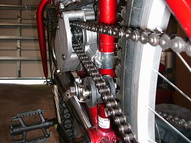

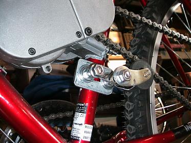

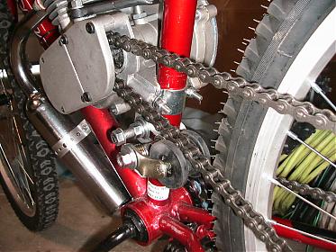

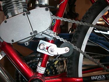

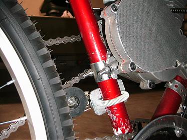

I was having a problem keeping my chain taut, and was very unhappy with the stock chain, so off to Tractor Supply for some #41 chain. Got the chain and got to browsing and also picked up a really sweet ball bearing, rubeer coated chain trensioner, AND spring, it is sold seperatly. After mounting the chain I took some 3/8 althread rod, heated it up and bent it into a U shape to fit around seatpost. I cut a strip of metal ( out of stock tensioner mount) to secure allthread. Then I just mounted the spring tensioner to the end of the allthread, the ID of the tensioner seems to be a good fit on 3/8" rod. Then a little adjustment and done. Spent $40. on everything including new chain. I have put a couple of miles on it an it is a lot quieter, and very smooth...

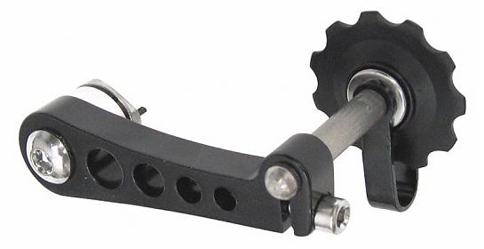

That's kind of what I used for my Dble. suspension bike. I do not have pic's of it. But here is what I used. I used a Idler sprocket and had to do some mod's to get it to work with the tensioner. Your set up look's much better.

Yes, it took alot of mod to work, and it was'nt cheap. But at the time I had a nissan timing chain tensioner that I was using. I was taking a trip to Mexico and there was no way I was going alone. The homemade nissan tensioner had a little to much tension on it because that was the only way I could keep the chain to stay on on the trail. And I was afraid to take a long trip with the way I had it set up. So it was kinda of a last minute set up I did with the tensioner and idler sprocket, but it worked great, held up all they way. The chain did fall of several times.
Your set-up is much better and I like it. I was looking at tractor supply but could not find it
