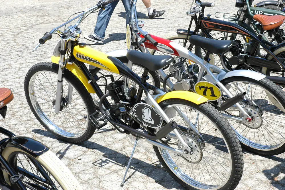

There is a lot of tweaking to do to a new motor kit to get them running as
good as that red Felt # 71 Huskie that you saw at the El Dorado bike meet [SEE PIC]
It is using the same Grubee Starfire kit that you got from me
I rode it and it was one of the nicest motorized 2 strokes in terms of drivability I
have ever riden
Raully and John do the cleanest best running installs ......
A lot of the noise and roughness comes from the crappy sprockets, tensioner and
chain in the kit
The teeth on the sprockets especially the 10 tooth front are badly machined and
make the chain clunk....
Soon I will have a CNC machined front 10 tooth to match the rear and that really
smooths out the ride
PS: Thanks to Rockvoice for the pics from the bike meet
