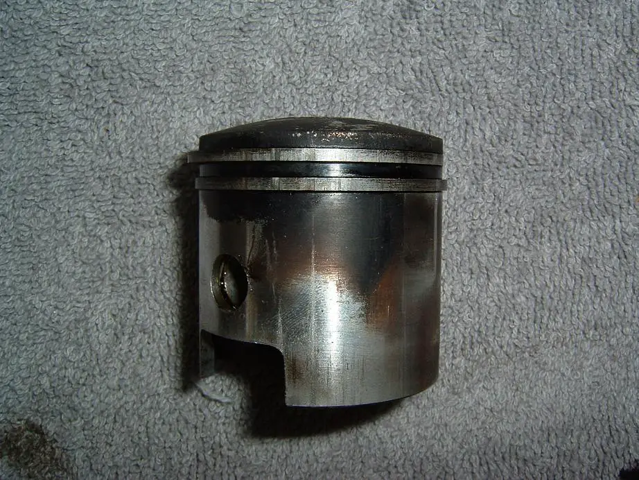

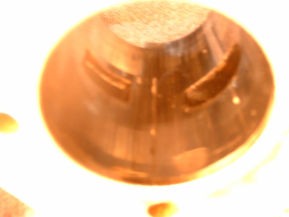

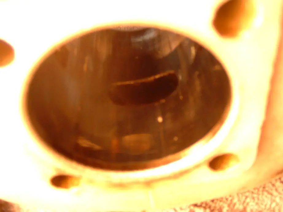

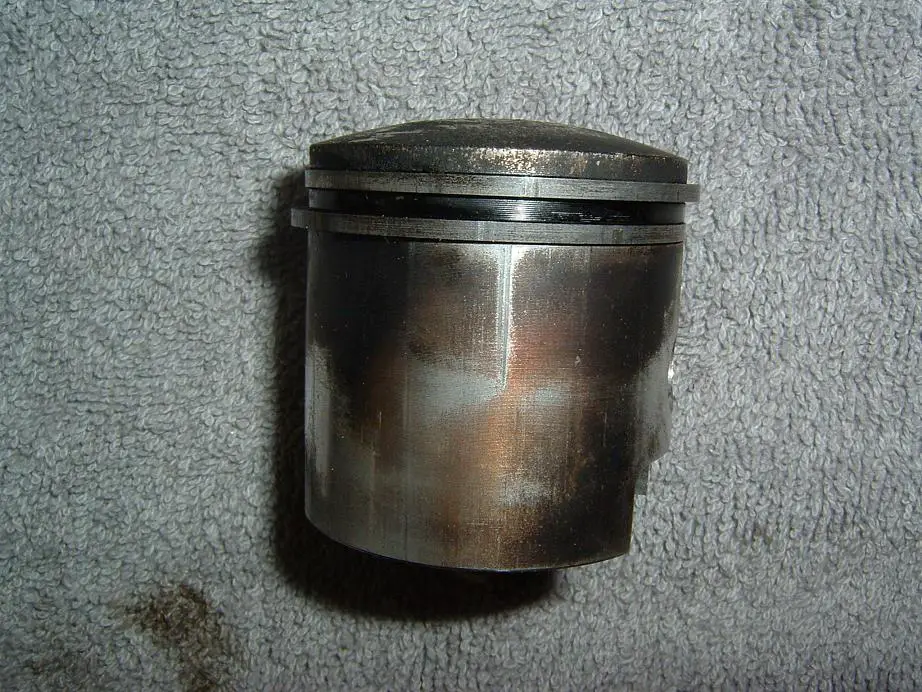

I've been having trouble with my 80cc motor from thatsdax. Had a long discussion with drhofferber (aka Dennis) on the troubleshooting forum, and I think we've pinpointed the problem, but I wanted to get a second opinion and maybe a little advice for repairing. You can look at the thread "Loss of Power" on the troubleshooting forum for all the details, but here's the condensed version:
-I put together my kit and rode it happily for about two and half weeks. Probably about 150-200 miles.
-I started it one morning and noticed I had a considerable drop in power and after the motor warmed up it would not idle unless I goosed the throttle now and then. The idle improved if I adjusted the idle screw all the way in (most open position).
-I started trouble shooting.. checked electrical system, tried a new spark plug and new plug wire, checked for air leaks, went over the carb, cleaned it out, tried various c-clip positions. With Dennis' help I think I was pretty thorough. After all that, I opened up the motor.
-I found a thick build-up of carbon on the top of the piston and all over the dome of the cylinder head. It was maybe a 1/32" layer of soot coating everything.
-I found some light scoring all around the piston and cylinder wall as well as a few deeper grooves on the piston and through the piston rings, and deeper scoring, through the chrome, on the cylinder wall. (I'll attach a few pics)
So... I think the problem is 1) carbon built up in the combustion chamber, 2) bits of carbon flaked off and caused wear on the piston, piston rings and cylinder wall, 3) loss of power and poor idle are result of poor compression. Does that sound like a reasonable assessment?
My questions are: 1) If I want to get it running again as cheaply as possible, does it make sense to replace just the cylinder, piston and piston rings? 2) It seems likely to me that there is some grit and crud in the crank case. If I do rebuild the top end, how can I be sure there won't be more stuff in the bottom end to get thrown back up into the cylinder and send me right back where I started?
I'll take any input anyone's willing to give. Thanks for looking!
-carkl

How many miles are on that thing? Carbon will not usually cause damage like you have.

A compression test would tell you how bad your piston and cylinder is looking at the piston and cylinder it don't look real good but pictures can be deceiving as low cost as these engines are and you bought it from Dax ask him if he has a reject engine maybe one with a casting flaw.They are perfect for parts even if the cylinder has a flaw( no hole into the cylinder) they run just fine.

No way. While that is some decent level of build up for so few miles  - no way was it caused by a carbon hunk. Either something foreign entered or something broke.

Pablo and bikeguyjoe, I know what you're saying. Carbon is too soft to make gouges like I've got. Maybe some burs around intake or exhaust ports, or piston skirt left after casting? I don't know... When I rinse out the crankcase, maybe I'll try to dump out the solvent through a screen... see if I can find any offending particles.

spray some kind of oil even wd 40 or light machine oil to keep bearing etc from forming any rust. You can sometimes pick up an engine from Dax that has a good piston,cylinder it might have an out side casting flaw that someone didn't like the inside of the cylinder etc is fine. You can sometimes pick up one of these engines for $40.00 lots of extra spare parts. Dax might not be doing this anymore. Your engine could have done many things to score the cylinder, rings, piston. Dirt inside is one, small parts of the chrome on the cylinder could of flaked off, left over metal partials from the manufacturing of the engine. You might of over heated the engine or ran it a little too lean on the oil mix. This is one of the things that sometimes happens. You could even have a main seal that is leaking or letting air into the crank case causing a lean fuel/air mix which will eat them up pretty fast. Any air leak can cause a lean run condition and over heating.
the cylinder base gasket or the crankcase's main gasket can leak if you have ever seen a black oily smear on the engine around a gasket area that is a sign of an air leak and needs to be fixed.
Bottom line your engine took some kind of a hit and has lost its power to run properly.
You need to decide if you want to spend the money on parts or replace the engine or parts of the engine. My way of thinking is these are cheap throw away engines parts can soon be more than a whole new engine kit. You will have to decide which is more affordable to you.
