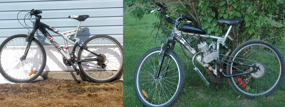

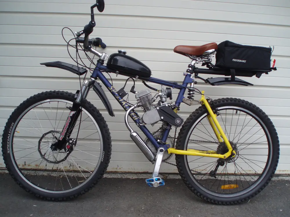

So many said "you can't put a motor on a full suspension bike.
Well I did and it runs great.
I started with a $30 bike, a motor kit and aluminum rods that you weld with a propane torch....and built a full suspension (go anywhere) trail tamer. There is a lot of modification but it can be done
check out the pictures.
Paul B

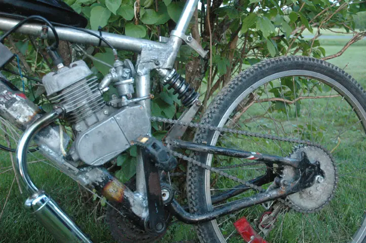

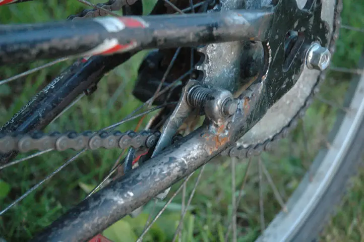

The trick is in the chain take-up.
I used the bottom part of an old derailleur to take the slack.
Works like a charm.

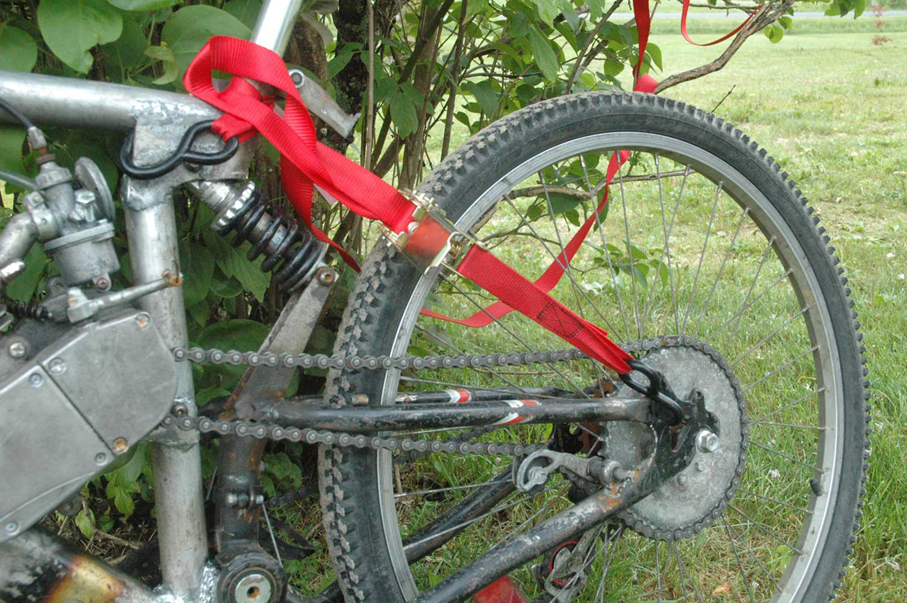

Another pic

thats a cool bike that you built,good job.

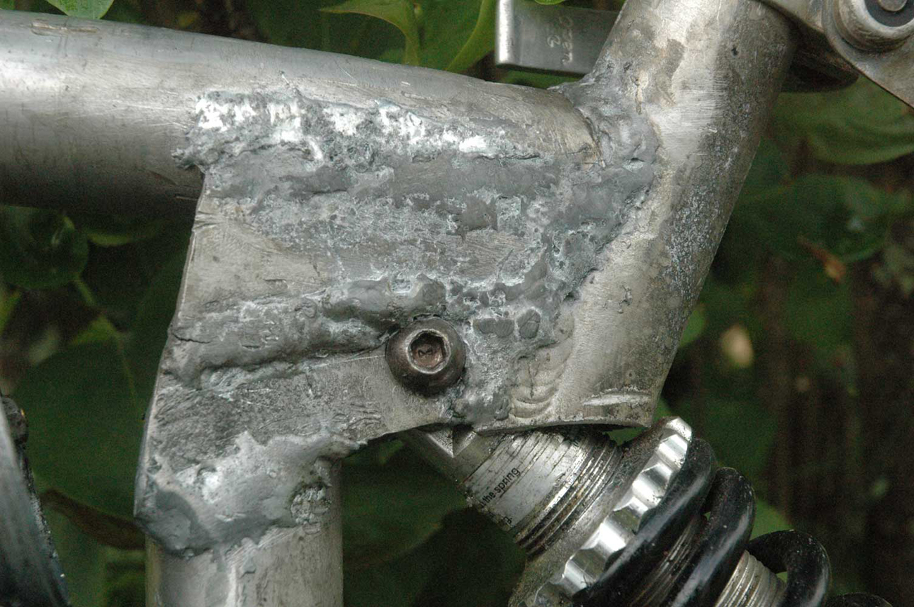

Well I never knew aluminum could be done like that with a propane torch Can't really make out the welds. Looks good cool job! I got a similar project That I scored the same rear triangle design in a steal version. Welcome to the forum! Is the tensile strength compromised any? I always figured tig was the stuff for aluminum. Looks like the angle for the spring will work. Close up picts if you will please. How does the chain on the China fair of with the sus?

Default Re: Full Suspension....Yes it's possible
The front frame is aluminum, the rear suspension is steel.
The aluminum welding is almost as strong as mild steel...so better than tig (my opinion).
Bike is experimental and took a while to work out the bugs.
Now that it's reliable, I will tear it down, clean it up and paint it.
No issues with the china chain...just keep it well lubed and it works fine. I use Rustcheck. keeps it lubed and rust free.

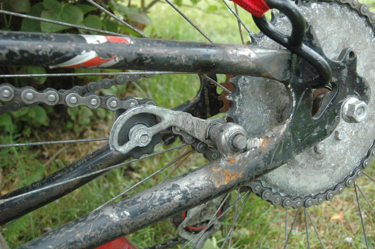

Here are close-ups of the tensioner.
Simple and effective.
The aluminum welds are not pretty but I will clean them up before painting.

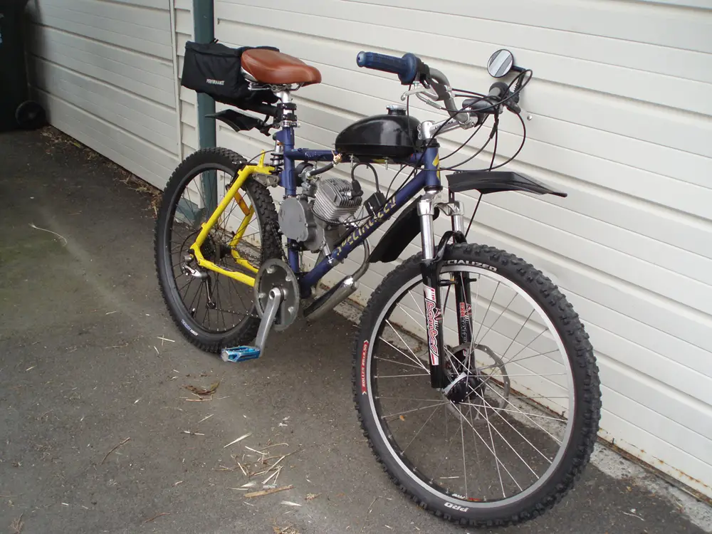

Nice job, this is easier though, no welding, but I love the innovation. I will admit that these style frames are hard to find.
