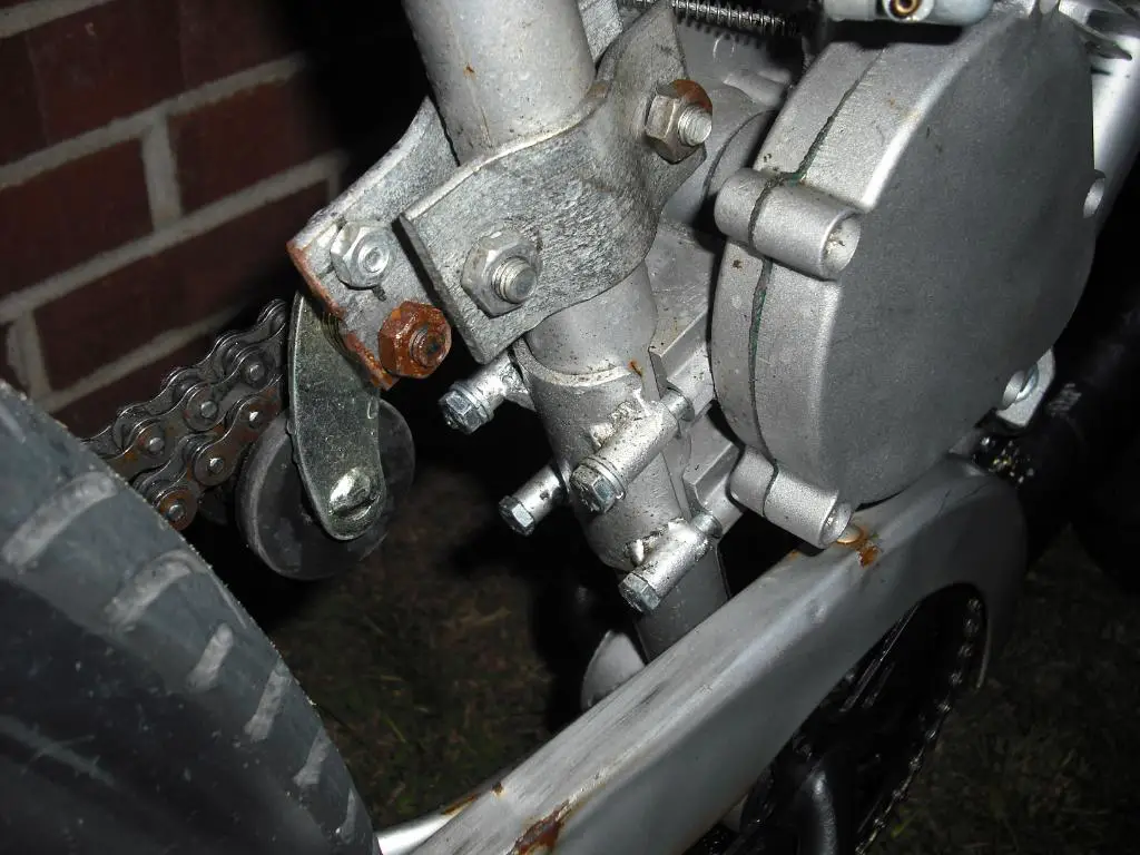

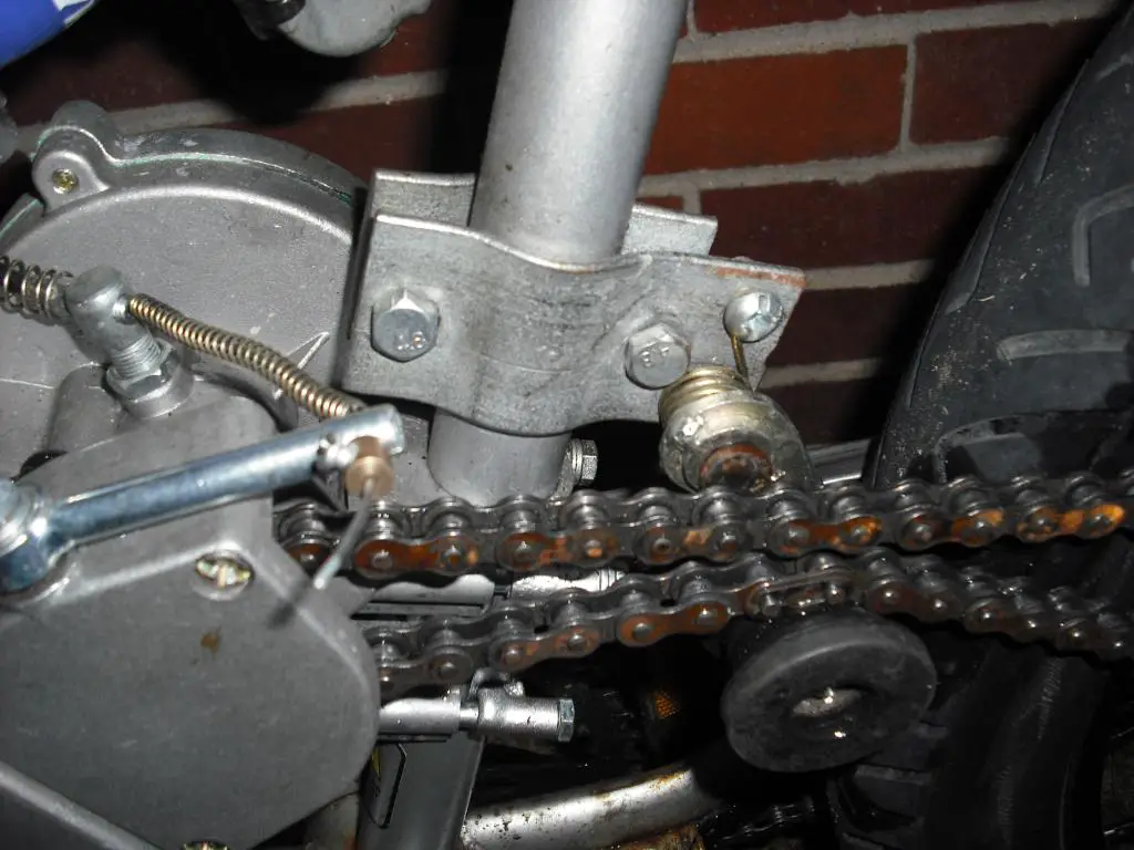

The stock mounting bracket for the tensioner can be used, with some modification. I used the stock bracket with the tractor supply tensioner and spring. I would think it could also be adapted for use in the location intended by the kit manufacturers.

Have you had any problem with the chain hitting together that looks kinda close?

Good eye, rimotorbiker. I do need to take another link out of the chain, as it does slap together sometimes. I haven't done it yet because I ordered a new clamshell adapter and sprocket from Creative Engineer. Have not installed it yet, though. I am thinking of getting a 36 tooth from Jim, I currently have a 34 tooth.

Thanks for sharing the pic marvin im thinkin of ideas from it right now.

No problem, that is what this forum is all about! I have been thinking about reversing the spring tension and letting the tensioner pull down on the bottom run of the chain.
