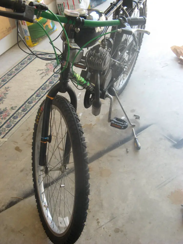

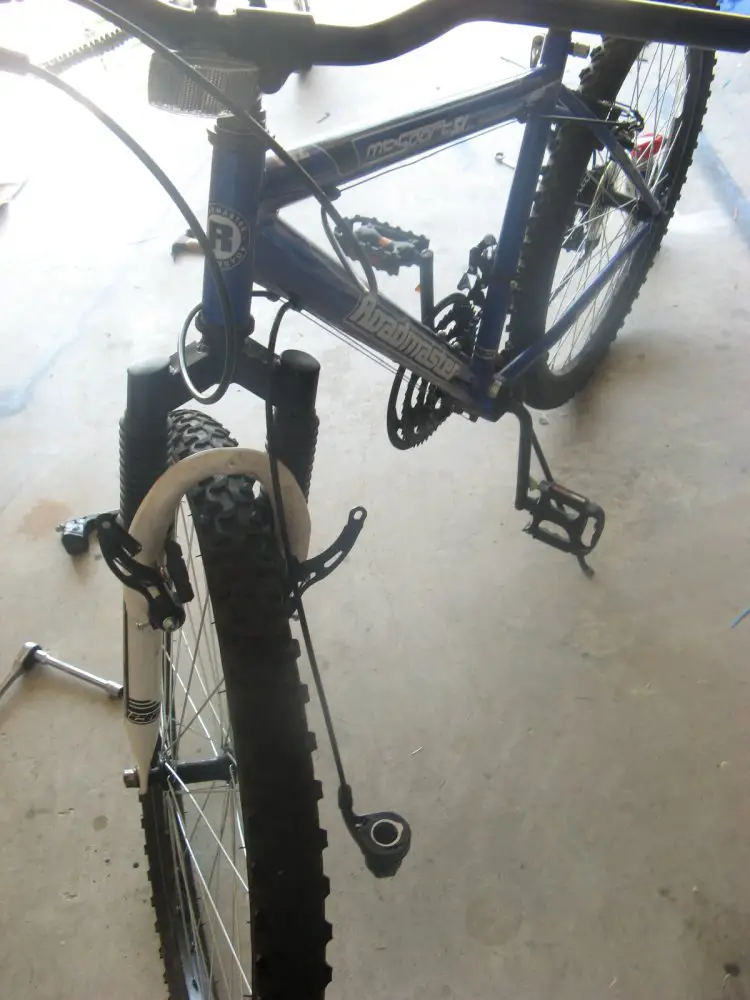

I came upon another bike that had front suspension, but the frame was too small for a motor to be mounted. And I don't (at the moment) want to make it fit. I tried to straight swap out the front forks of my MB with the suspension forks, and quickly found out the incompatibility factor. The suspension forks had a shorter thread pipe and I couldn't get them to attach.
Suggestions? Would replacing my front forks with suspension forks even be worth with?

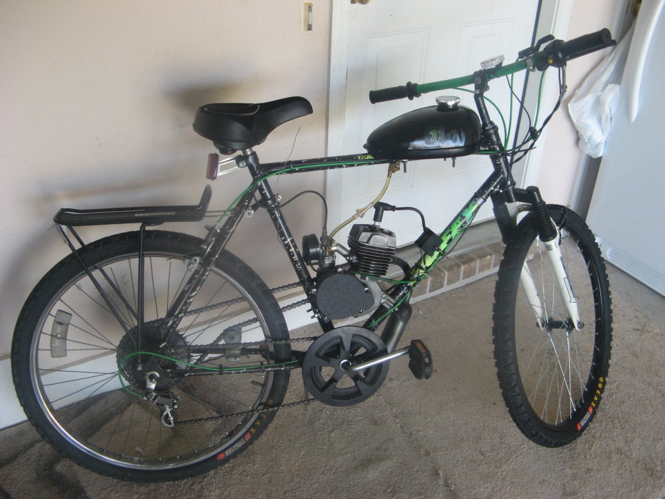

well, my neighbor and I did it but I forgot to take the before and during pictures...All i have is the after, and thats not that exciting. I will say that front suspension makes a TON of difference.
since the fork pipe with the threads wasn't long enough, we had to cut the pipe, and insert an extension inside it. my neighbor has a stick welder. after welding and grinding smooth again, the length was perfect.
you might also notice that these new front forks also have better brakes.
