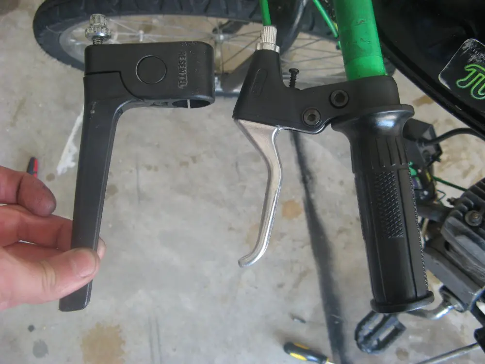

Not that this is a unique tip by any means, but I thought I'd share non-the-less.
My stock puller was replaced with a shorter, more angled puller. The result is a better clutch action. Before, the clutch was barely disengaged, and with usage, it would stall at a stop b/c it wasn't fully disengaging. Now, I get more pull and more action out of my clutch arm, it is nowhere close to engaging.

I'll have to try that. In a 50 mile commute, I will have to adjust my clutch cable 3 of 4 times to allow my clutch to fully disengage.
