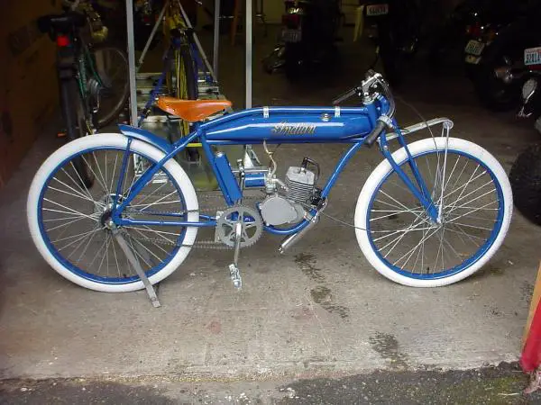

7.Torpedo style gas tank ( Indian ) or box style gas tank like ( Harley ).

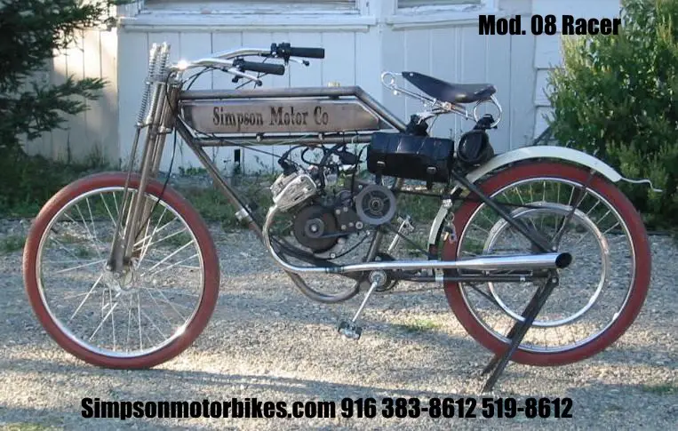

Today's Builders who have gone down that same road are here in the Forum, like Motor Bike Mike of Simpson Motor Bikes builder of The Model 08, 09 & 10 Racers & although probably not a member of the forum George Whitney of Deuce Motor Bicycles who use's the Worksman Industrial Newspaper Boy bicycle in Burien, Washington.

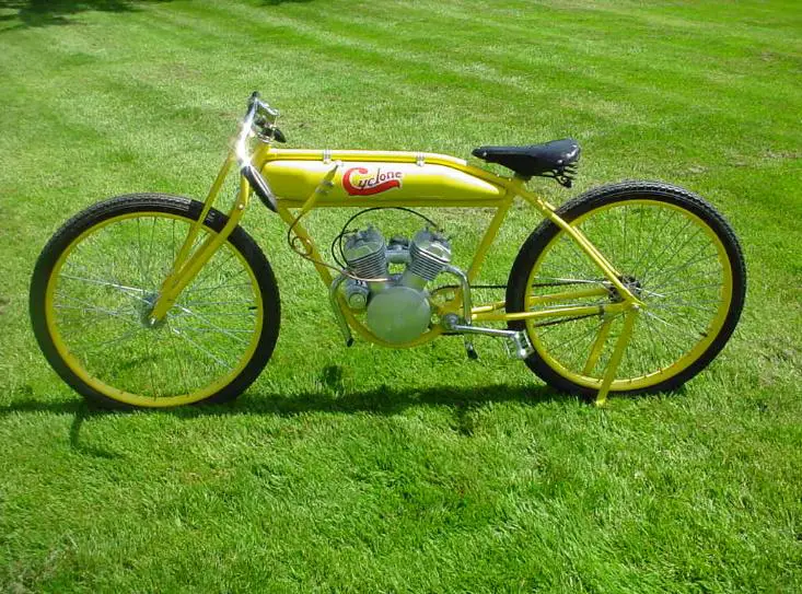

hey Crazy Horse, tell us more about the yellow cyclone in your last picture, that looks like a modified Chinese engine in it.

That answer would have to come from your neighbor and builder of that Cyclone tribute bike over in Burien, WA suburb of Seattle isn't it, his name is George D. Whitney of Deuce Motor Bicycles check out his web site for more info.
Wish I had more info!
