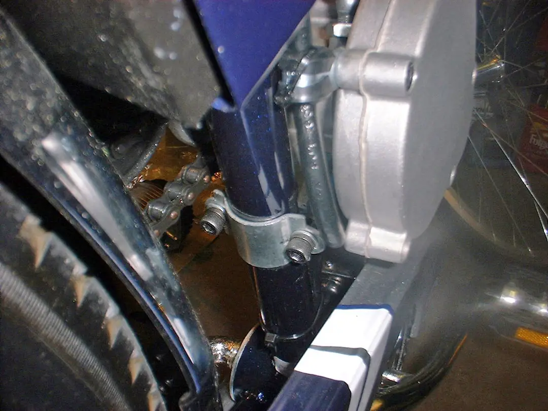

You can safely grind enough to make the saddle portion of the front mount fit your downtube. It won't take much and and the aluminum is easy to remove. If you have access to one, a Dremel Tool with a sanding drum works well. Work slow and check your fit often while grinding. You will be fine. As for longer fasteners there is no requirement for them to be studs with nuts. Allen head cap screws work beautifully and you'll find the size you need in a grade 8 bolt at Ace Hardware. I've attached a photo of my rear mount using the Allen head cap screws instead of studs. Sorry, I didn't measure them so I can't give you the proper lenghth but finding it isn't hard. Double nut a stud, screw it in until it bottoms out then measure the amount of thread in the block. Add enough to reach your clamp with a lock washer subtract about 1/4" and there's your length. Good luck, keep us informed.

I added a picture to my original post but it didn't show as an update. Just scroll back to link #4 for a pic of Allen head cap screws in place of studs. I also added some info on sizing the bolts.
