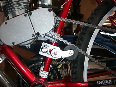

Well grinding off the chrome helped a little bit. A spring tensioner, some all thread, nuts, bolts, and washers from Tractor Supply took care of the rest....
Not sure this is the correct place to post this, but here it is......
