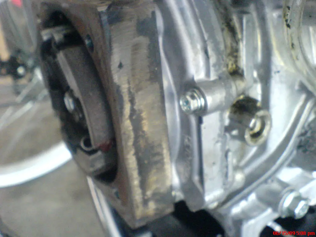

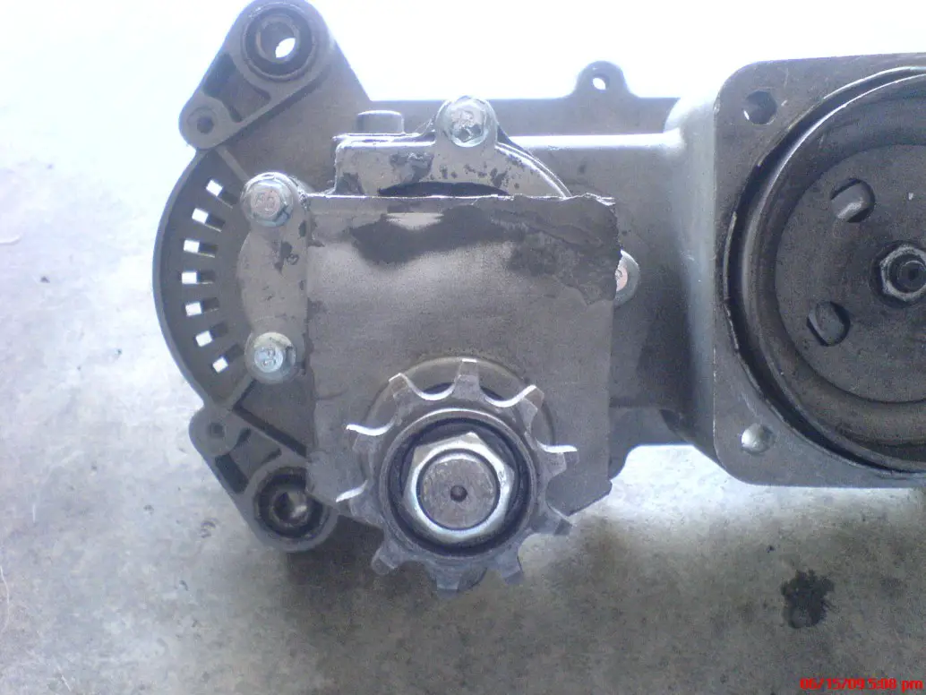

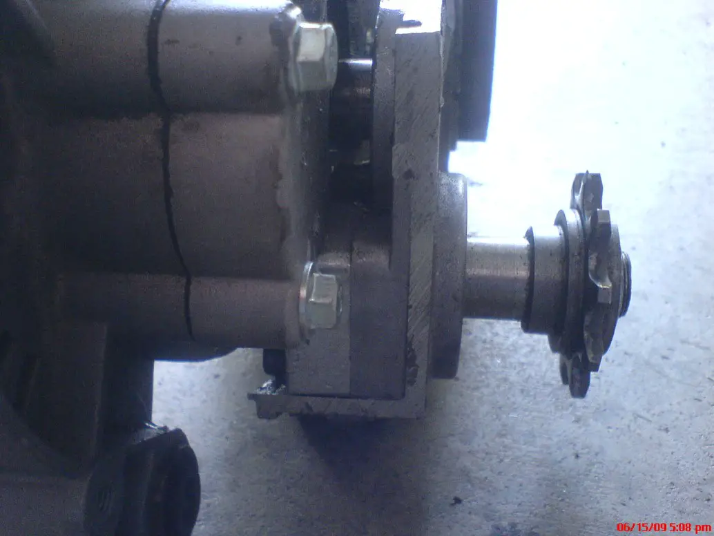

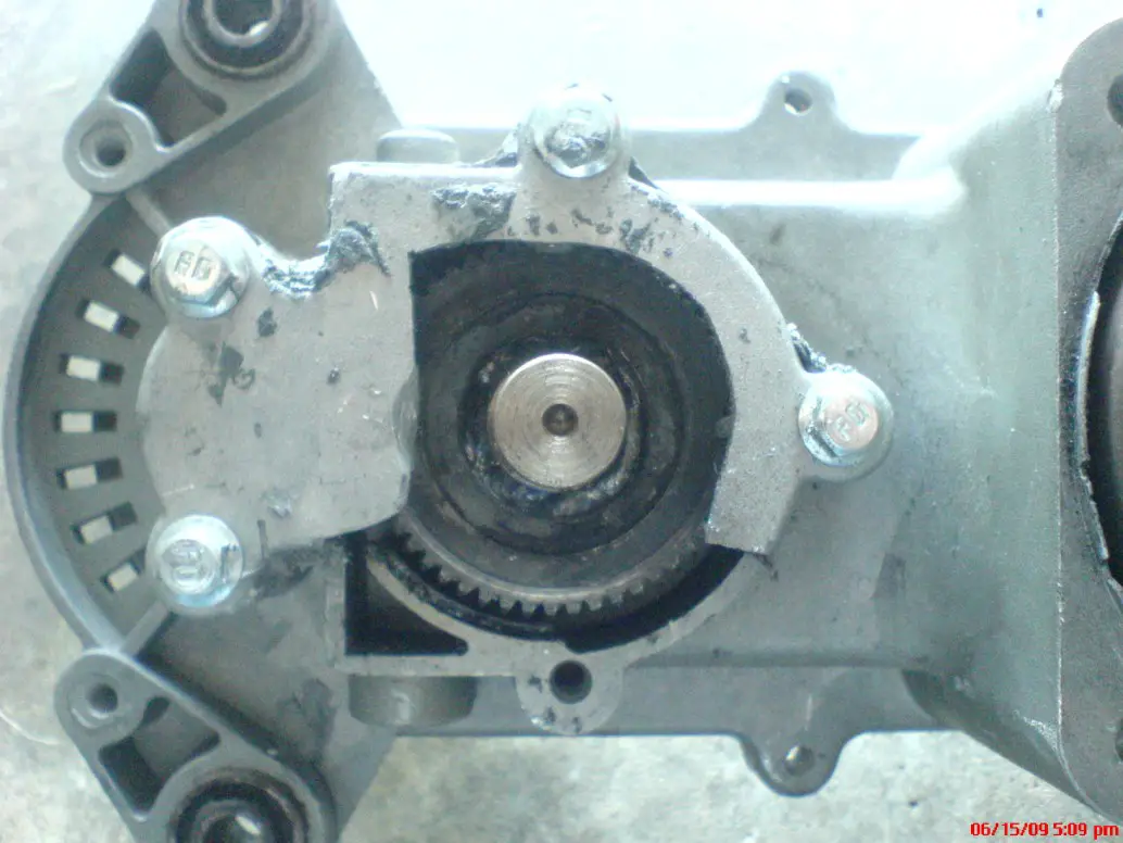

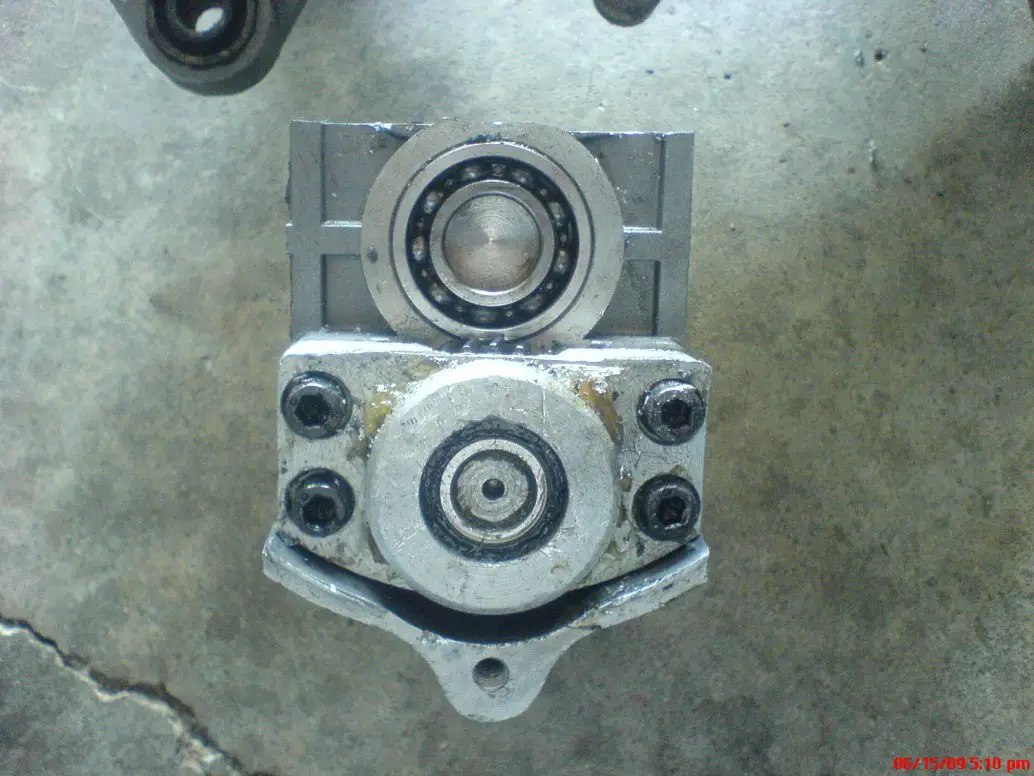

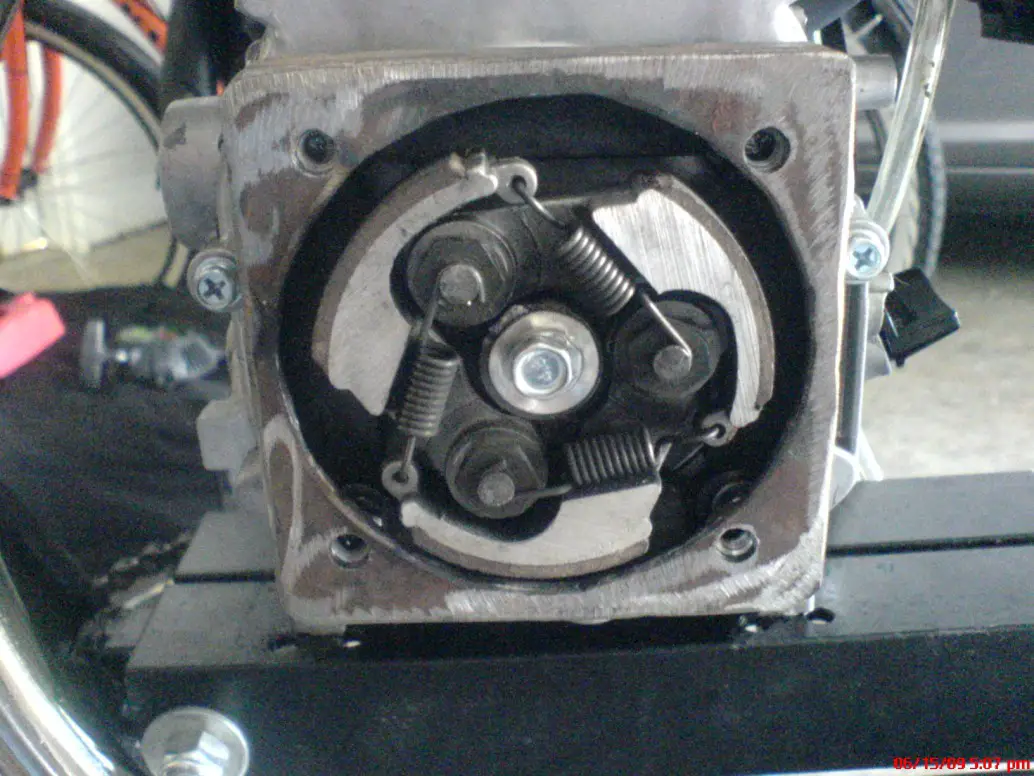

I wanted to give you guys a few pics of what I have been working with. This is the adaptor for the engine and the cut up hoot gear box on the cvt. I haven't worked with it any lately, been down with my back. I will update as I get back into it. I modified my exhaust, moved the engine over about 1 inch to the right to align the sprockets and then the thing came apart. The two different pieces of cvt and gear box were held together with the epoxy. That is what I have to overcome. I am going to try and weld them together after I can move with my ailing back.

Here's the last pic.

Woops! Forgot the pic.

Civlized, Hope The Back Straightens Out. Have Had 45 Yrs Of Bad Back! Can I Ask, Why You Are Doing All That Modification To The Output Shaft On The Cvt Transmission? What Are You Gaining? Ron . . . PS I put the dots after my name, keeps the exhaust out of my face! lol OK, I JUST READ A PREVIOUS POST OF YOURS, TO CHANGE ROTATION.
