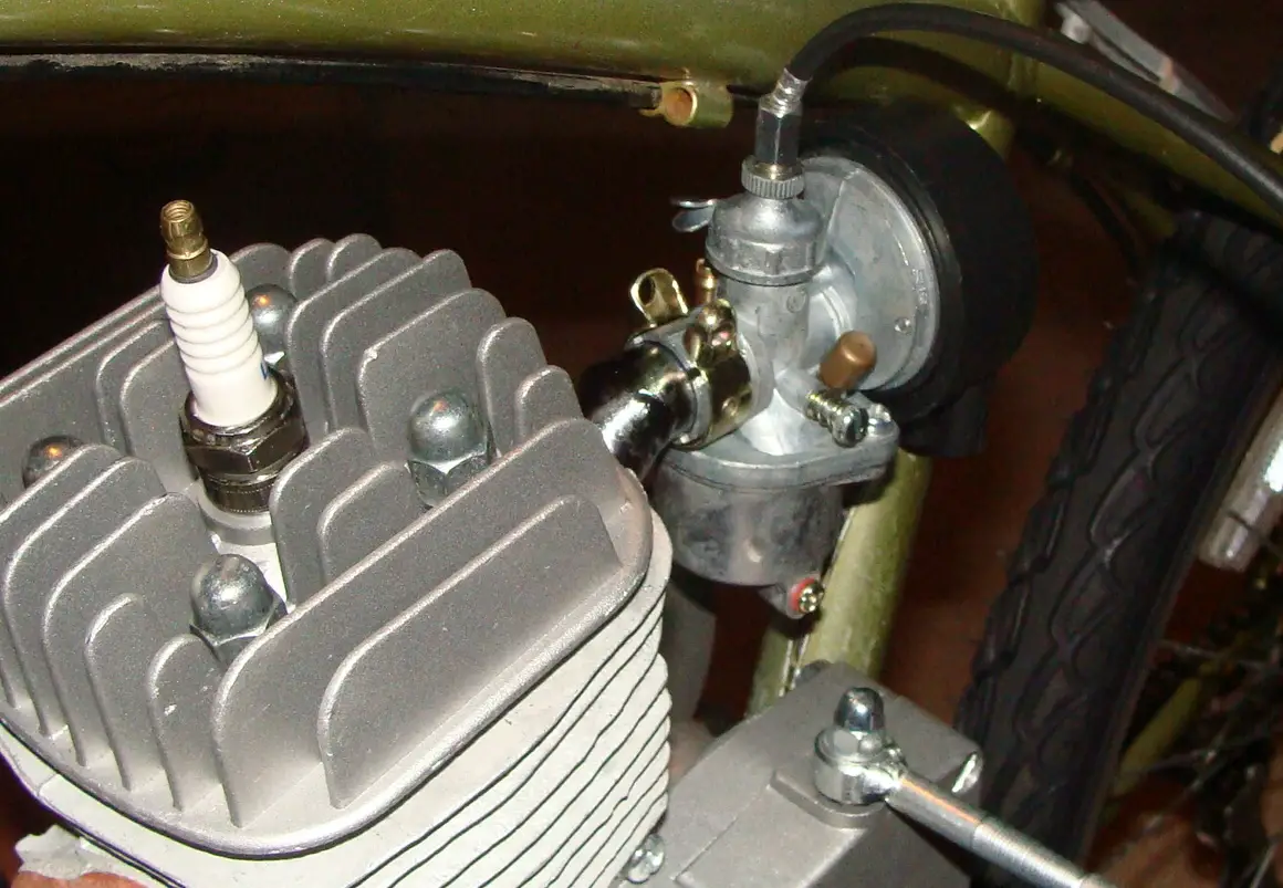

tascott....i had similar problems...had to go with a slant head...shortened my intake and drilled a small hole on my top tube for my trootle...now everything is great...ha...Dennis

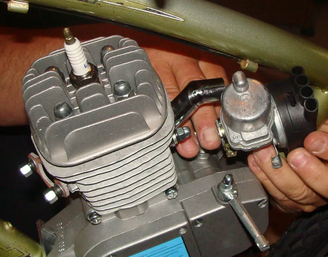

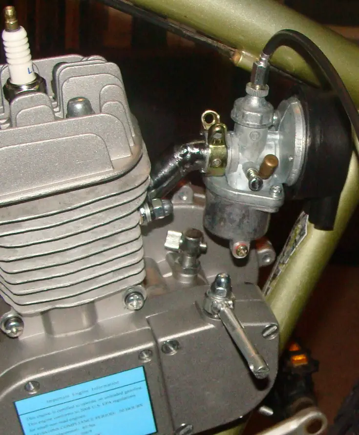

Have access to a wire feed welder? The tube is steel from a junk import car heater hose transfer tube. The thinner tube makes for alot bigger inside diameter and better flow.

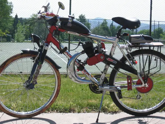

Maybe I'm missing something here guys, but looking at drhofferber's bike I have to ask why are you mounting the engine so high in the frame? If it were lower, closer to the crank you'd have sufficient clearance for the plug and carb. Also your chain wouldn't be at such a sever angle. The lower the motor, the better for weight distribution and balance also. Just wondering.
