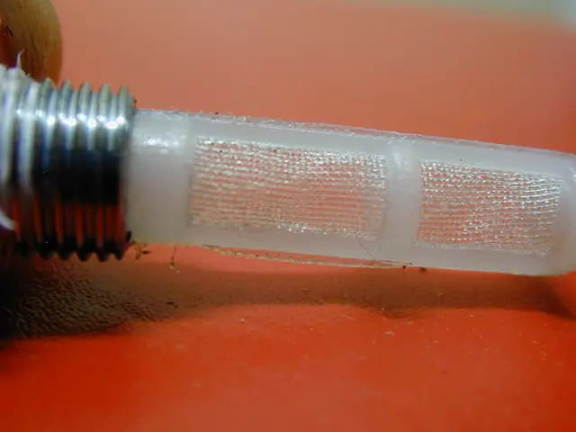

OK... I disconnected the fuel line from the tank and opened the petcock to drain the fuel.
The fuel drained out slowly in about the thinnest stream of fuel possible without dripping. How fast should it have drained?
I would have thought it would drain as if through a thin straw. I removed the petcock... the filter above the petcock looked clean. So the thin flow of fuel was caused by the filter screen, a smaller orifice inside the petcock valve, or something else inside the petcock?

You are clogged somewhere It should make a darn messy puddle quickly! It should flow faster than that . The petcocks clog up very easily , when trash gets to them. Are you sure the screen in the tank is not clogged? They fall apart very easily too! That will clog the petcock. If your kit did not come with one do get a in line filter. I had a fit with my set up . I did away with the tank filter . Then I used a swamp cooler water cut off valve it has a bigger orifice flow channel to it. But thats just me.
