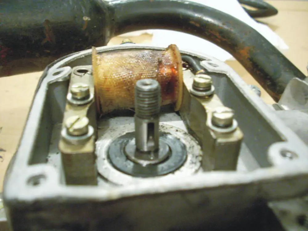

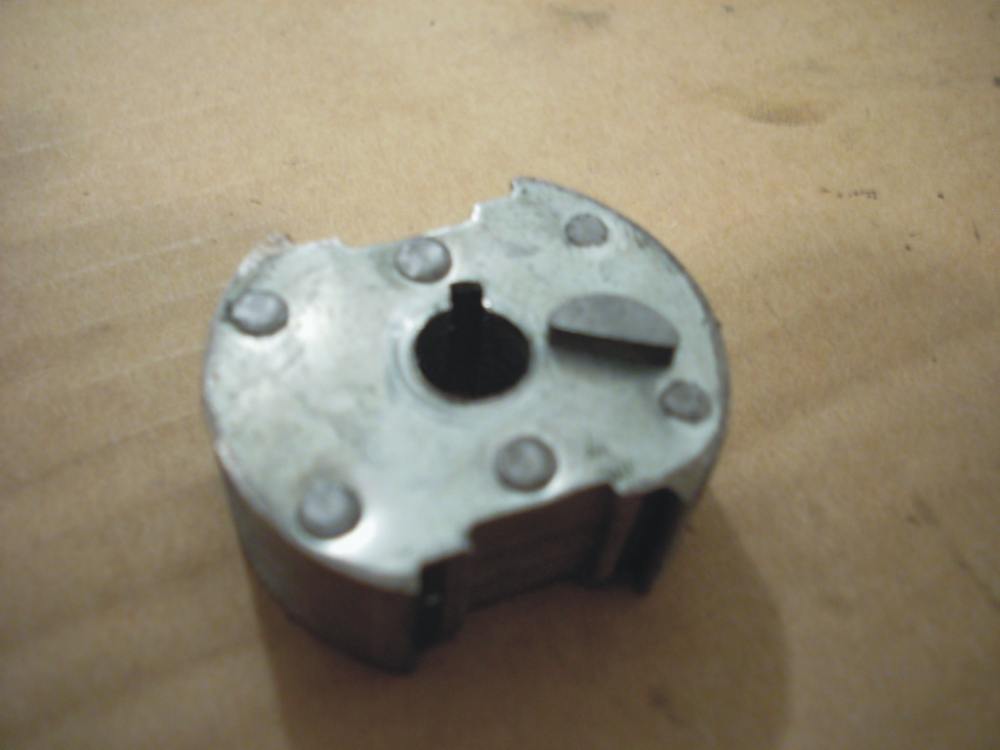

Take off the cover on the left (mag) side and look at the spinning magnet. Make sure it hasn't come loose and rotated to throw off the timing. It should have a key in it. It should not touch the mag frame when it spins. If your head gasket is blown or leaking you'll have oily goo around the head. It will give you a loss of power but shouldn't make it backfire thru the intake. If you have a broken ring you should be able to feel the compression loss when you try to start it. If not pull the plug and roll it over with your thumb blocking the hole. You should not be able to keep it plugged. A broken ring will scar it up the cylinder pretty good usually. You can just pull the head off and check the cylinder wall for damage. If you have to pull the cylinder off Chris Hill's site has a great walkthru for putting back together. GL

You original problem could be one of several. The magneto rotor, magnet, is indexed to the crankshaft with a keyway and woodruff key. It is rare but there have been reports of that key shearing allowing the magnet to shift its position on the crankshaft which would alter the ignition timing. That will certainly cause a backfiring that might appear as popping and fuel being pushed out of the intake. The alignment of the key and keyway are hard to confirm unless you remove the magnet from the shaft to inspect it. Be careful here and don't damage the crankshaft or the seal behind the magnet. Have a look and get back to us with your findings.

Thanks guys, I now see exactly what you are meaning with regards to the engine idle screw. I was totally mistaken. I carefully took the carb apart today and examined it, and now I have a much better understanding of how it is working. I inspected the float and chamber, and that thrash at the seat of the needle valve; everything was clean as a whistle. If it is the carb bowl giving the prob I'm not too sure what it could be because everything in the carb seemed to be in place and the float was not stuck or anything?
Thanks for your input 2Door: I carefully took the magnet off to get a look at the keyway and woodruff key. To me it looked un-sheared, which is good thing I guess, but also bad because the breakdown is still a mystery? I'll try post I pic to get that 2nd'ed though?
I have been searching about this forum and read a thread about how bad water can be on the magneto? Thinking back, my bike did get rained on that morning it broke down; I did not think it would have been too drastic tho.
