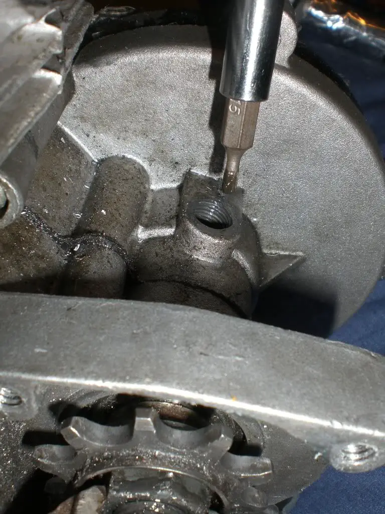

Next you are going to have to remove the clutch guide and get an Allen wrench between an 1/8" and 3/16" and put it in that hole. Pic
You also put grease down that hole too. Lubricate the innards of the clutch.
Next make sure you spark plug is removed, and loosen the flower nut a little bit.
If you have the motor on the bike you can simply turn the rear wheel clockwise to tighten the inner clutch spring. (I don't have a pic of this one) You will notice that when you are turning the wheel the Allen wrench will grab on something (you want it to do that, that means it is catching the nut on the spring to tighten it), The tightness of the spring depends on how many revolutions the sprocket on the motor turns, a few times around should be good. It all depends on how tight you want the clutch.

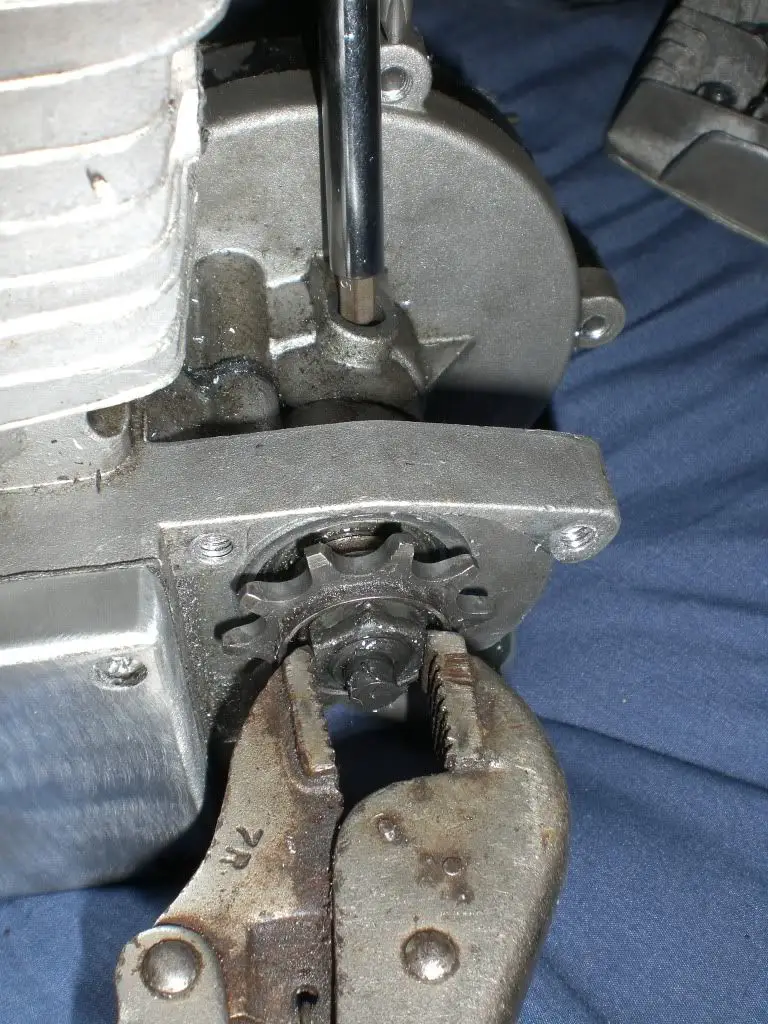

If you Motor is off the bike or the chain is off you will need to do as above as far as removing the clutch cable and guide you will also need to remove the clutch cover.
You will need a pair of channel lock pliers or a pair of vise grips. In the pic I am using vice grips but the pliers are better. With the pliers grip in between the sprocket teeth and turn clockwise to tighten it just like before.
You will notice that you clutch is a lot tighter and you can now tighten or loosen the flower nut till you find a place where it is good for you.

The nut holding the drive gear on is actually the same size as the spark plug. So you can use the spark plug tool there. And not risk rounding it with vice grips.
Nice Tip keep them coming.

Sounds good - my only .02$ would be for a casual user is to choose a different holding tool - seems like that Torx bit could fall out of the holder and be stuck in the hole!
The bit wont go that far inside. If you look at manics diagram. you will see.

Yeah it probably would just sit there - but I don't use anything smaller!

I couldn't find an allen wrentch that would fit unless i spent an hour looking for them. That is why i used a spare torx head
