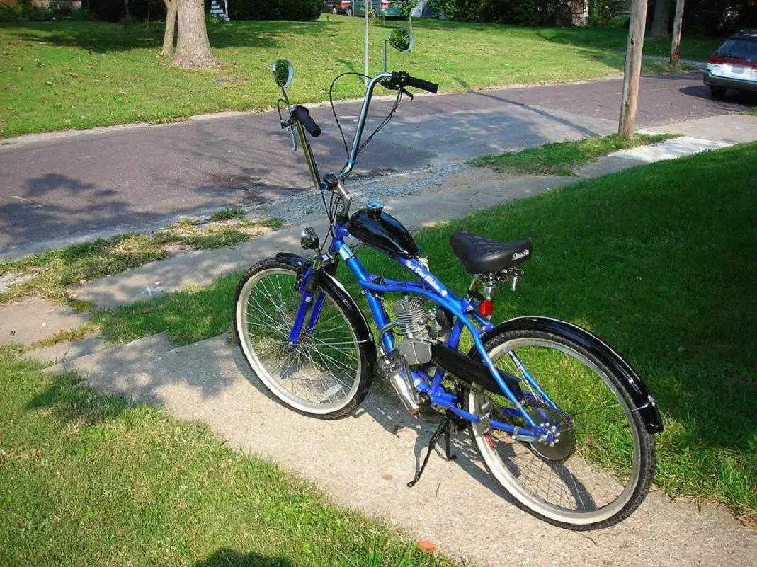

I used a pacific brand cruiser single speed bike for my first build. It offers a rugged style frame, wide tires, nice seat. In addition I added suspension front forks which also had front brakes. The end result looks like an early motorcycle. 600+ miles later I still ride it to work on a daily basis.

Slight modification by way of cutting an area out of the rear fender for the chain. I also drilled a hole in the front down tube of the frame to mount the motor. At the time the large diameter wrap around frame adapter was not available.
