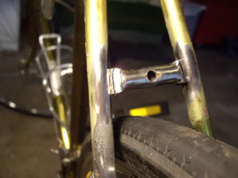

Back home a with a thorough scrutiny I spotted a sneaky little crack all the way through the rear brake mount between the seat stays. I was glad that my motor wasn't causing the noise, but a cracked frame isn't really GREAT news. The stress and vibration of the 2-cycle might have hastened the metal failure. But the motor mounts that I made by brazing pieces of iron plumbing pipe together are doing fine after a couple thousand miles. The frame is a 1973 Continental and it looked pretty beat up when I got it, so maybe there was a weak spot to begin with.
In the pic below the motor and brake caliper is removed and I've stripped down to bare metal for the welding. My neighbor welded it for me and it looks sturdy now. Since it's all apart, I'm making a better motor mount and will have to repaint the back end. I'll try to take some pics of the interesting parts as I go.

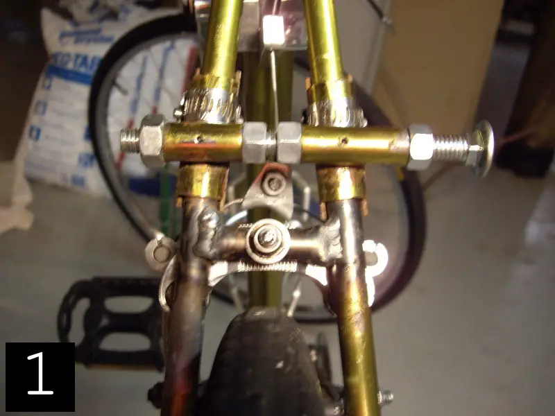

Pic 1: Old mounts. I'll call them pivot mounts since the motor actually is bolted to a steel plate and the motor and outboard bearing pivot together. These old pivot mounts show a bolt and nuts going through them just to hold them in the original orientation for laying out the measurements of the new mount. Old mounts were clamped to frame seat stays with 4 hose clamps. (Only using 2 in pic for illustration). The hose clamp system worked fine, but I was never really "proud" of it.

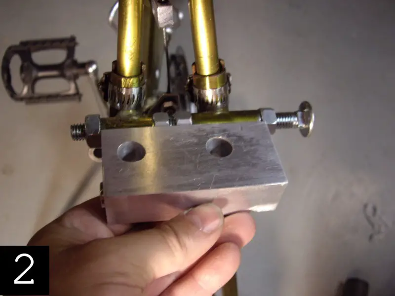

Pic 2: Size up. Block of aluminum with holes drilled at same angle as seat stays. Getting the spacing and (especially) angle right was tricky. I have a cheap benchtop drill press and 10$ calipers.

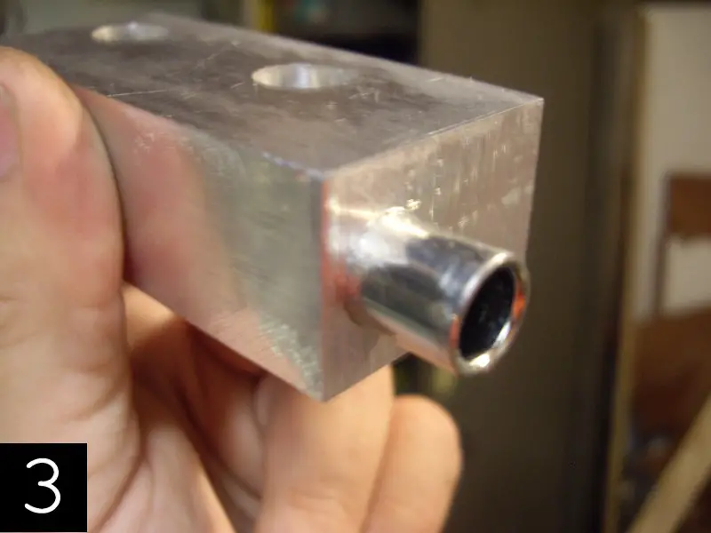

Pic 3: Spacer out. The 3/8 inch threaded pivot rod passes horizontally through mount. I didn't want the steel rod to wear out the aluminum and get sloppy so steel sleaves (spacers) are used; 1/2 OD, 3/8 ID. They'll be J.B welded in. (Never used JB weld in my MB before, but it seems to be a popular item)

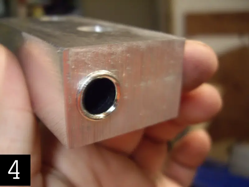

Pic 4: Spacer in. As Ace Ventura would say; "LLLike a glove!"

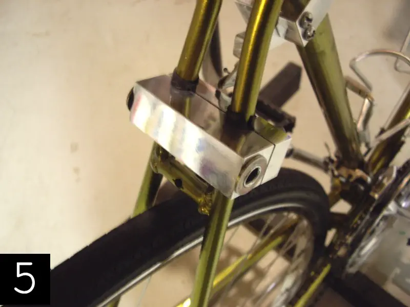

Pic 5: Clamped. Skip forward quite a bit. Block has been "split" on band saw to clamp around seat stays. Spacers epoxied in. I let them extrude beyond the edge of the aluminum the thickness of a washer, for better side wear. Then the mount block was drilled and tapped so there are 4 allen-head bolts clamping it to the seat stays with a layer of inner tube rubber for damping.

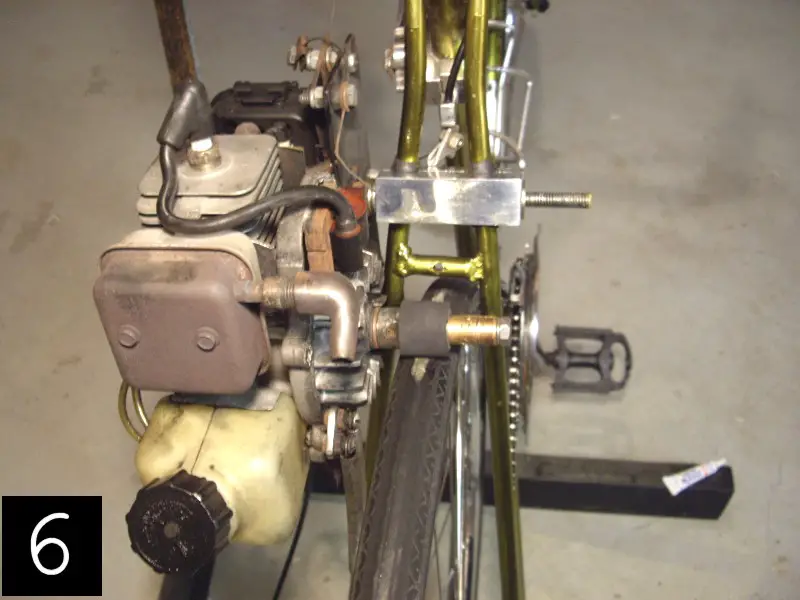

Pic 6: With motor rear. Pivot rod is through pivot mount. Friction roller is resting on tire. I don't know if it is my camera or monitor, but to me the colors are too bright and contrast is harsh. In real life things don't look so rusty and dirty. The rear brake, outboard bearing, springs, etc... are still off. But with everything on, especially the roller guard, it's hard to tell what you're looking at.

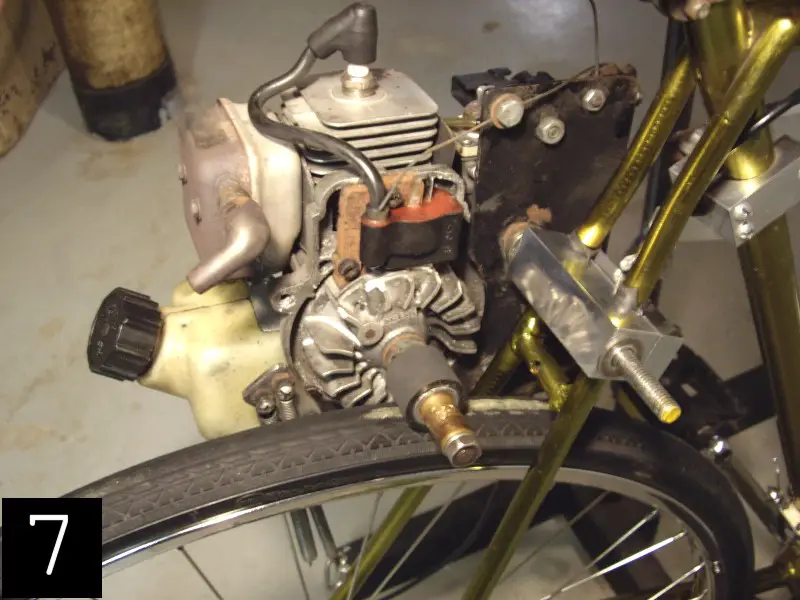

Pic 7: With motor side. Hope you can tell how the motor and roller pivots on the tire.

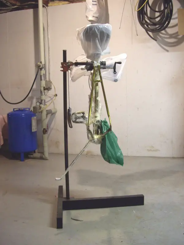

One more pic: On rack. She's all wrapped up with paper, bags, and saran wrap for the repainting of the back half. I never painted on a frame that wasn't stripped. Maybe as a stupid kid, but even then I think not. Bike rack is homemade from a woodworker's iron pipe clamp and some lumber.
