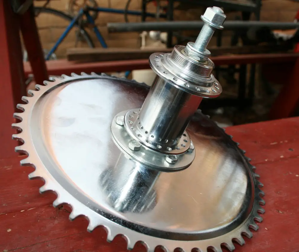

I just got a H/D rear hub kit for my bike but cant see how to go about setting it up. My bike is a peddal start but I cant see how to put a free wheel gear on the hub all it has is a place to thread a drive / pedal gear / on the right hand side . Is there a free wheel gear that can screw on to this hub?? ,any body have any ideas on this. I have included a photo of the hub so you can see the right side.

here is want you need a BMX Single Speed Freewheel http://ecx.images-amazon.com/images/...iL._AA280_.jpg Be aware that people have been experiencing problems getting these to thread on properly on the latest batch of these Hubs to make it here to the US

Thanks ocscully. I went to the local bike shop and he had one that threaded on with no problems.
