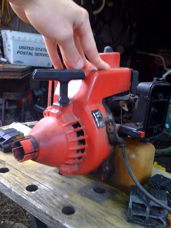

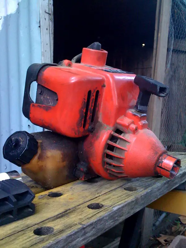

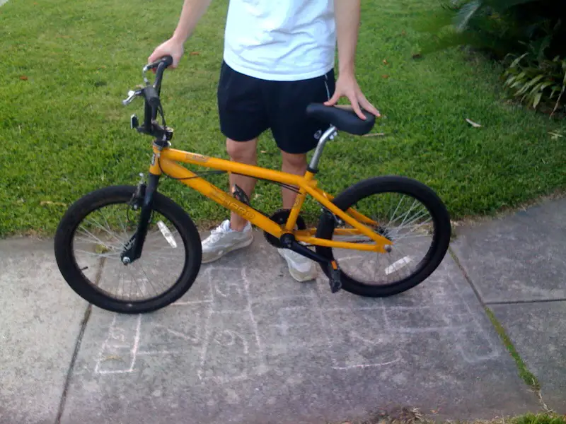

Old 06-08-2009, 08:06 PM
aaronmorg aaronmorg is offline
Join Date: Jun 2009
Location: Louisiana
Posts: 13
Default Re: My first motor bicycle (project)! Help needed.
The engine is a Homelite ST-275. Not sure about the CC.
Here is the bike I am using along with a left/right view of my engine.
ID:	9217   Click image for larger version
ID:	9218   Click image for larger version

matt167 matt167 is offline
Join Date: May 2009
Location: usa
Posts: 420
The engine, being a bit older, may be a bit larger in displacement.. probably somewhere around 40cc.. it is probably too old for an EPA sticker which would list the engine displacememt.. I really don't know how you would do a manual clutch.. in all reality, chain drive is impractical for a weedeater engine..
