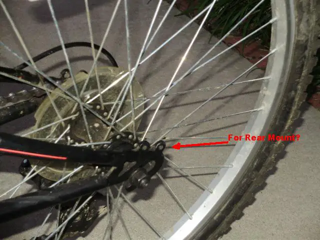

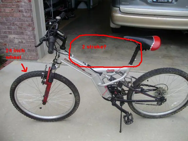

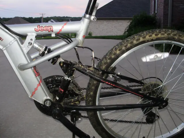

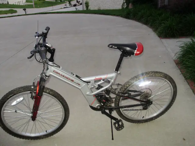

Cool NEED HELP- mounting a 2 stroke engine on Jeep Mountain Bike
I've got this Jeep Commanche TS Mountain/Suspension bike from Toyz R Us(pimp, right? :P),
and i need help mounting a 2 stroke engine on it. I was wondering if there was any way to mount the engine in the front because it's definatly not a V shaped frame. If there is ABSOULTLY no way you can mount it in the front, then how can i mount it in the back?
-any help appreciated, thx!

Sorry, but that bike will not lend itself well to a 2 stroke, in-frame installation. It is not impossible but the work involved will require some serious fabrication and alterations to the basic bike. If I were you and was intent on using that bike I'd explore a rack mount engine. Rack mount means the engine is mounted over the rear wheel. Check this vendor for ideas and pricing. bicycle engine kit, bike engine, bicycle engine, bicycle motor Hope this helps.

could simply use a chopper frame mount ( like what the Schwinn OCC choppers use ). build a rack that it would attach to, and run the kit that way.. would be kinda screwey but that's the only way I can see a china 2 stroke working...

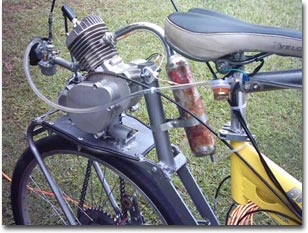

Here is one option if you can do a little fabricating.

I agree with Fair. Put it on the back wheel. You can find some way to
mount a rack to fit your rear triangle and use a rack mount motor.

Just an off the wall thought, but your bike looks like it would fit a morini motor under the down tube. That would be awesome.
Big bucks and some fabing though.
