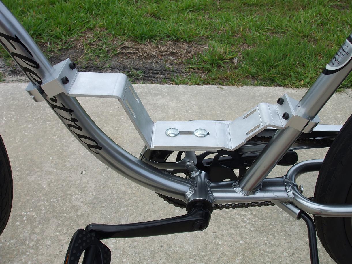

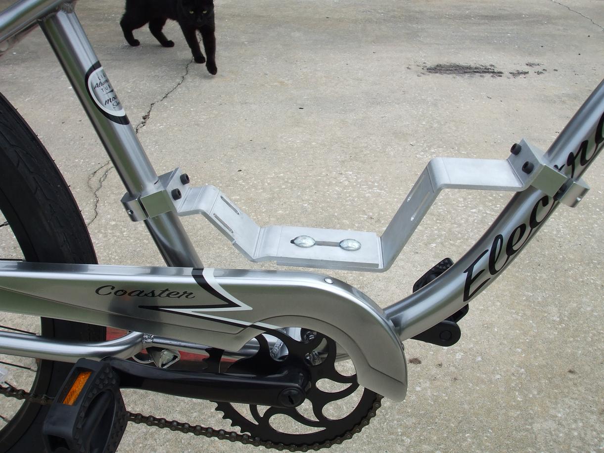

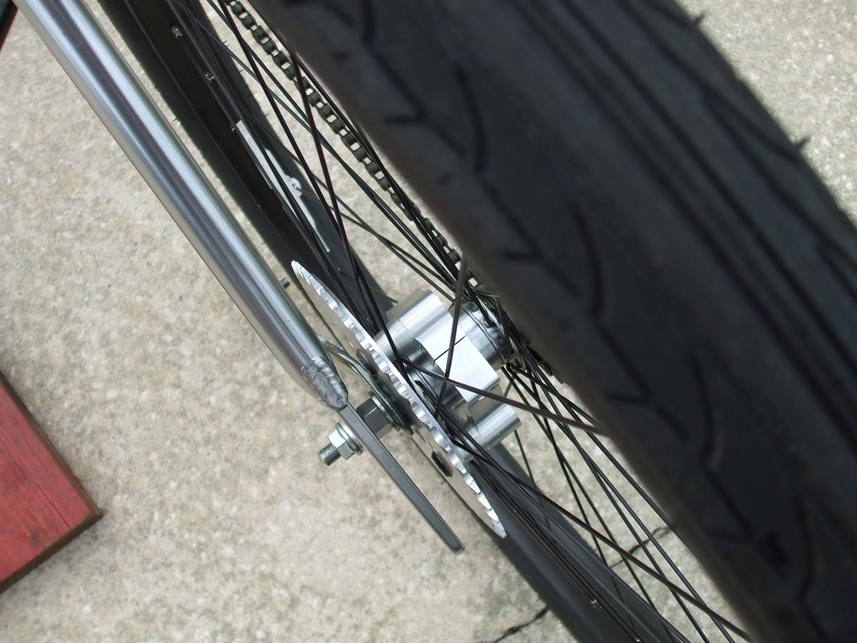

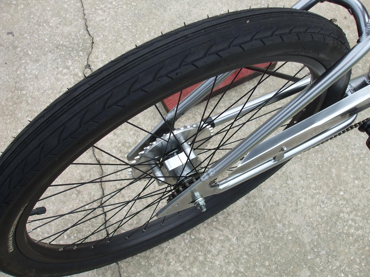

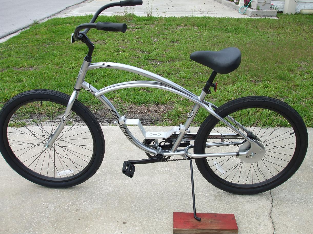

I took my new Electra down to Jim at Creative Eng. Sat. to get a motor mount and strocket adaptor and sprocket. Jim designed the motor mount for a Dax F80 engine. The mount was built for the engine's cylinder to end up upright to be able to use a straight intake that he makes. The sprocket needed to have the button head screws counter sunk and the button head screws heads machined flat for clearance at the brake arm. Alot of thought was put in this project to to try to design a good mount and sprocket set up . This is were Jim realy is at his best. The pictures is showing the progress so far.
