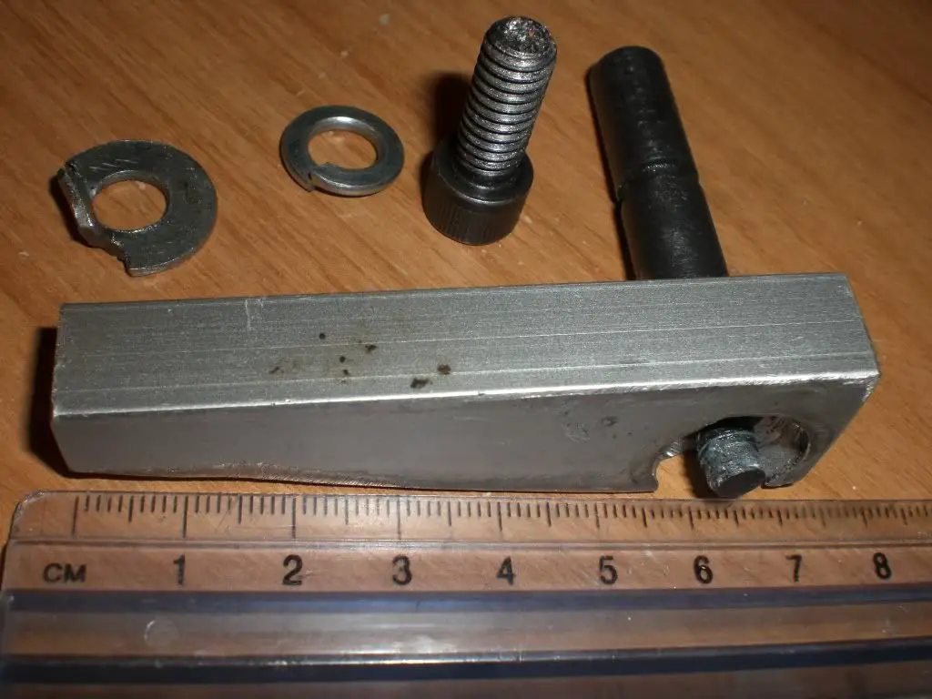

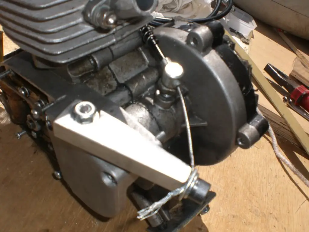

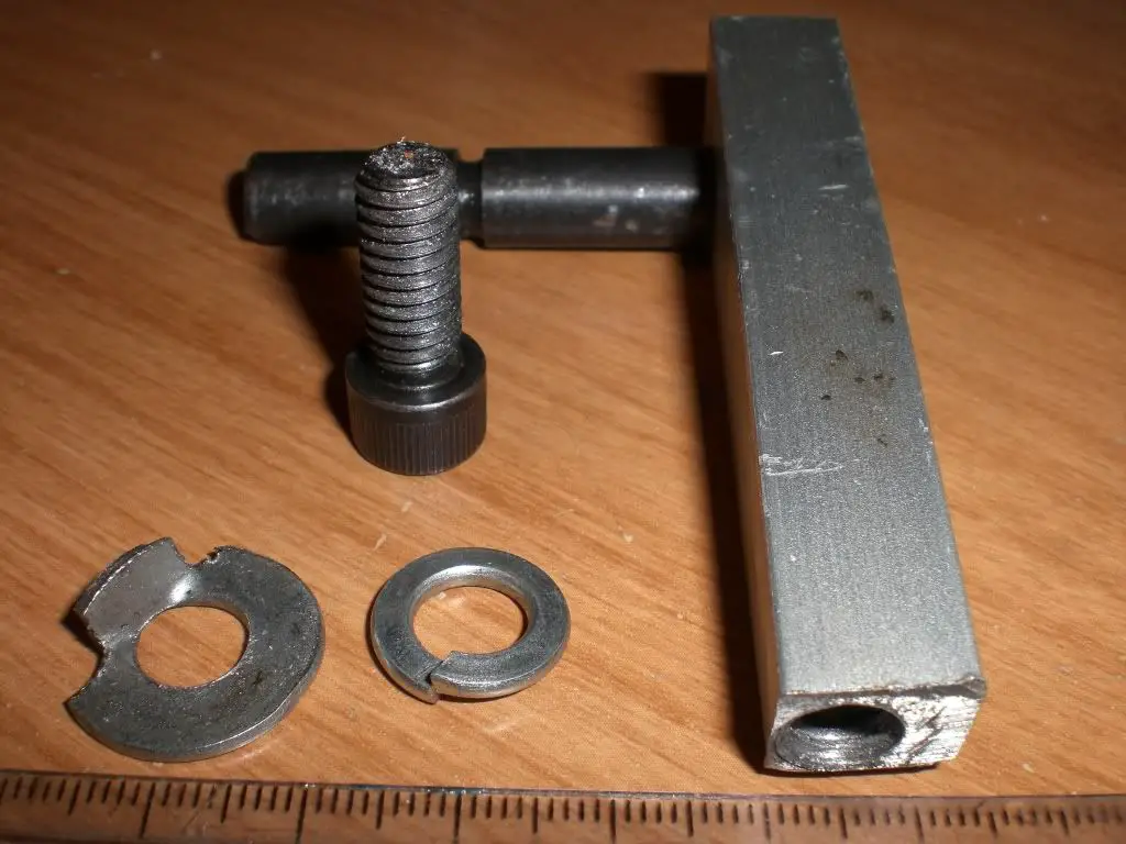

Another solution is to lengthen the arm, pop the arm off the rod, find some tubing (I used copper) and slide over the arm to make it longer (just about 1 inch) rotate the arm inward and reinstall on the rod.

i have a long and bent one i got on a 50slant i got from BGF...it works great...always new ideas...thank you...Dennis

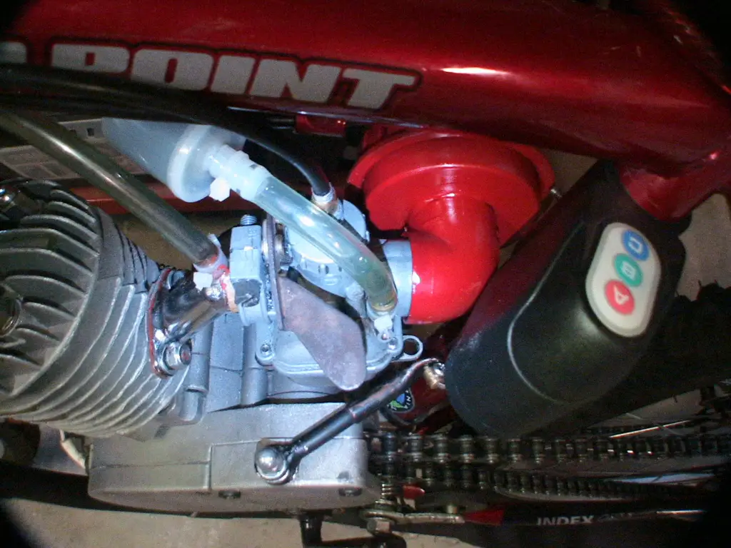

hey mister right, what is that on the intake pipe? and what is that black box on the right side of the pic??

i think that is a alarm for his bike....i use to have one for when i took my bike to work...ha...it makes a cherp sound...at least you know someone cares...ha...what i want to know is how misteright1 99....how you fabricated the intake filter....thats sweet...thanks for the pick...Dennis

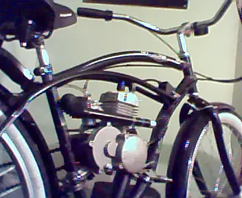

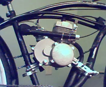

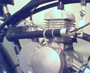

i like his intake filter too i think he got it off something else. i made one using a rubber boot from a bike shock and 6" aluminum pipe.i ran the hose to the carb and turned it around the side of engine and taped a aluminum pipe to it and pointed in frontward and tied to clutch cable,its like a forced air intake.

The intake was tapped for a boost bottle which I dont use anymore.

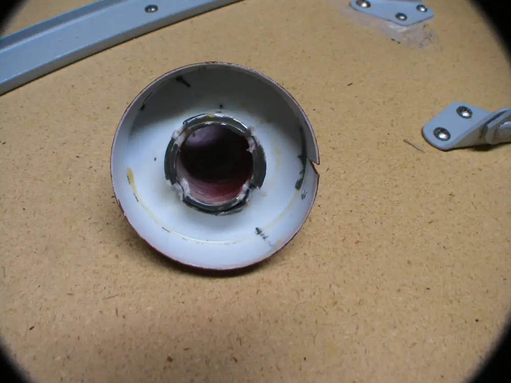

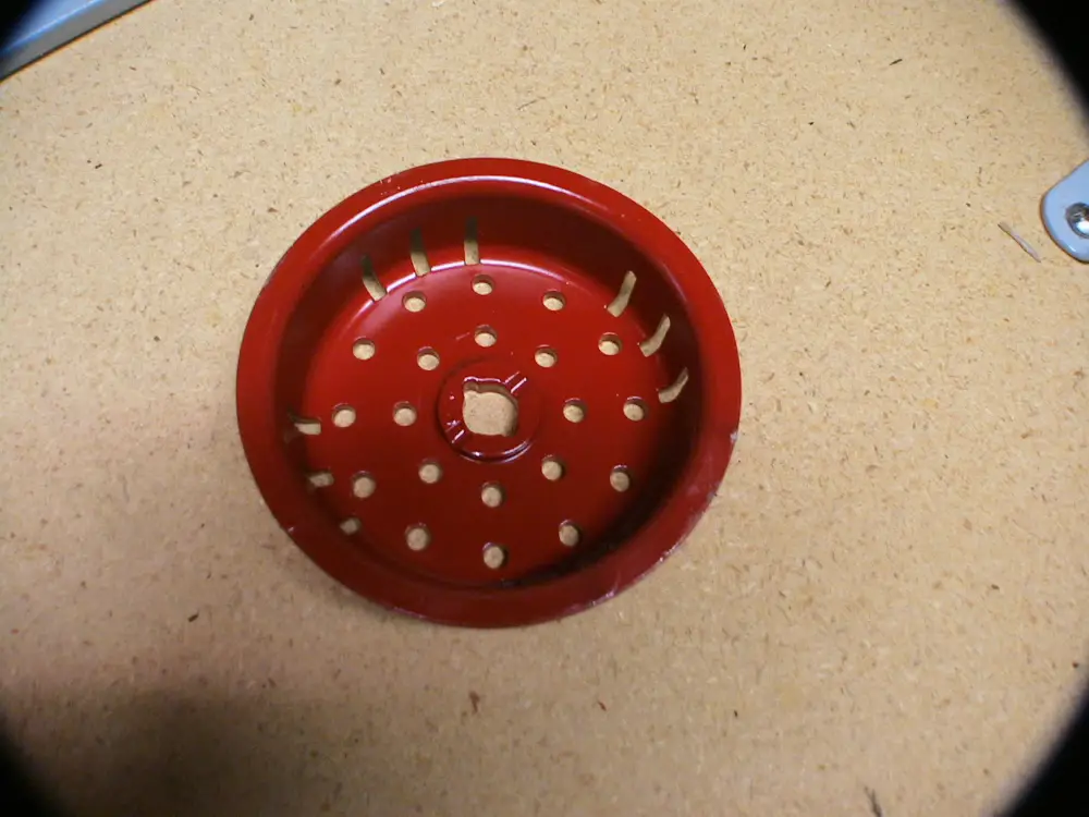

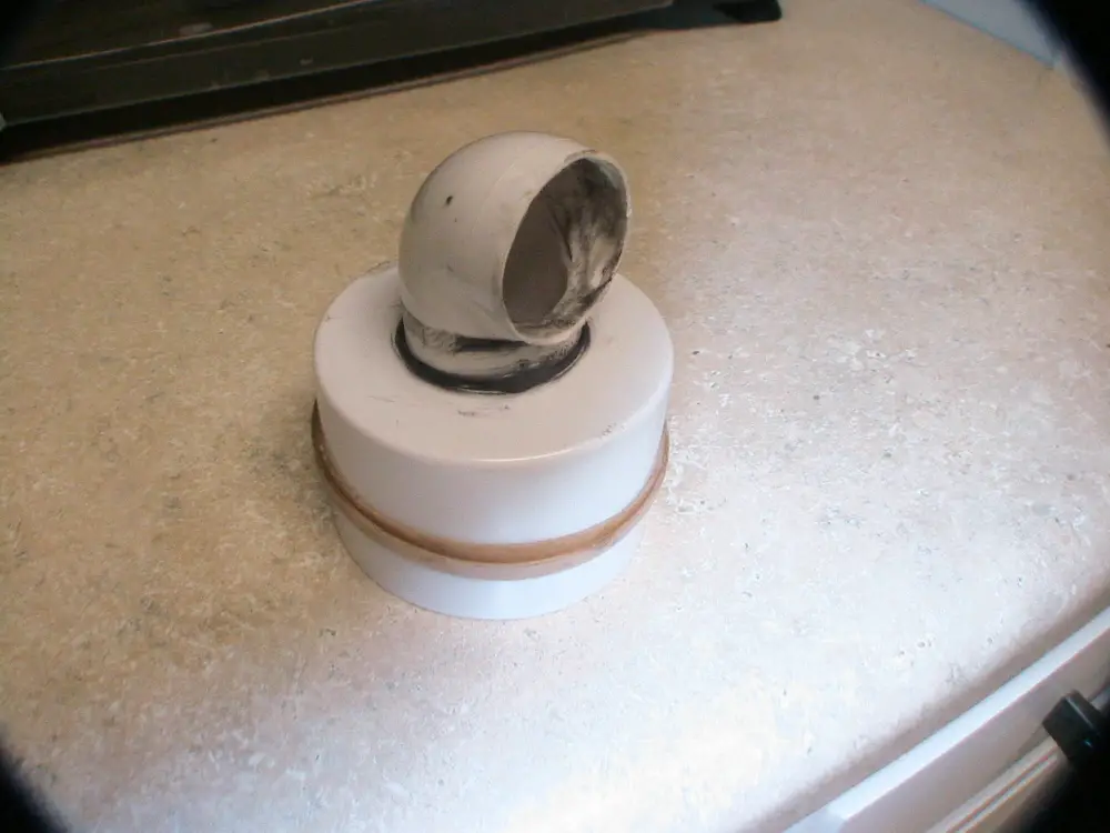

The filter consists of a 3/4" pvc elbow, part of a cover off a can of spray paint, and a dish strainer
