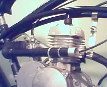

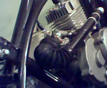

i added a forced air intake pipe on mine,its a rubber boot from a bike shock hooked on the end of the carb then its turned forward along side of engine and connected(taped)to a 6" aluminum pipe tied to clutch cable. you can add a filter to the end but i didnt yet.
it runs alot faster than a stock airfilter plastic thingy.
plus i use a o-ring in the carb to intake,stops airleaks.

Cabin fever do you have pics of your mods Thanks

here you go beetle some pics of my mods.

Cabinfever- That’s an interesting idea, haven’t seen that before. Certainly looks good. That might be a good way to solve an upgraded air filter space problem. Have you run it with and without the forced air pipe? Could the better performance be mainly from the lack of an air filter? I wonder if the pipe had a slight taper if it would have an increase Venturi effect?

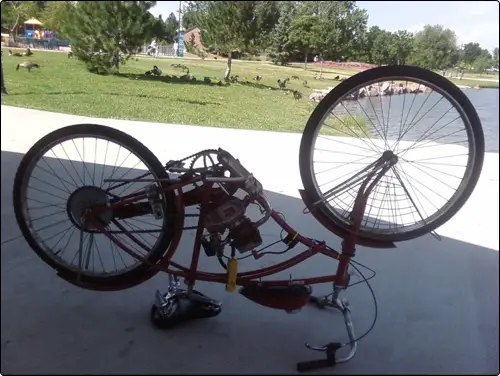

1st pic is MOOP2 upside down full tank not leaking any fuel.
Work on your bike remove wheel and fix a flat do anything practically on the side of the road like any regular bicycle.
Gas tank mod used a filler cap made for a boat picked up at a marine shop.
Used epoxy clay to seal the tank. Also have a spare cap with two small holes drilled
in it for when I ride so my tank can breathe. When it sits I replace the solid leakproof cap.
Someone steals your bike with that solid cap on it will quit on them after about a quarter of a mile. Chances are if witnesses see him he may just dump the bike so it's an anti theft device too.
Even in the float bowl it doesn't leak I think it's because of the vacume this creates in the tank.
And when you store your bike,the gas does not evaporate or disapear.
You can almost store this indoors yo.

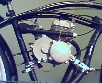

2nd pic is my frame mount rethink on MOOP2. Since my frame is skinny enough for the stock mount to grab the frame the stock front mount is grabbing that frame and on the rear I added another rear
mount. It hasn't loosened up or anything. This is idea for the old style frames where the mount
will hold tight. You can substitute that second mount for anything with two holes drilled to it even
a piece of hardwood I would imagine.

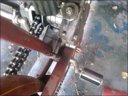

3rd pic is an old pic of MOOP1 before this forum was even born. You see my clutch mod but also
check out how I used my derailier cable stay as my clutch cable stay. I redid this to MOOP2 later on
with a frame clamp. Clutch pull is effortless.

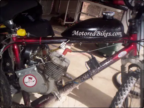

4th pic is a choke mount on the handlebar. I used a front derailier clamp for this. With some thinking
anything is possible.
I didn't transfer this to MOOP2. Instead on MOOP2 I moved my throttle to my left and my clutch
lever to my right. That way I can fiddle with the choke with my right hand while my left hand is doing the throttle.
And when you are adjusting your idle when you are stopped clutch is on your right hand left hand is adjusting your idle screw.
It makes things alot easier for me. Also it feels vintage because early Indians have their
throttle on the left as well.
Try it. It may blow your mind so you have been warned.
Throttle will turn the wrong way but I think it gives my bike a certain character.
