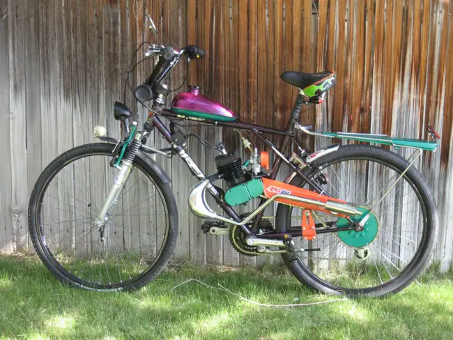

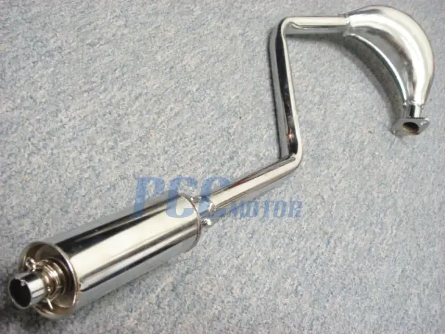

iy looks that if you purchased a straight intake from jim at manic mechanics and ground it at a angle it would work...or even created a wedge for the intake...what size engine...if its a 50 or below, you can buy this system for thirty dollars, it put 5 mph on my top end...thats with shipping....ebay...type in mini pocket bike exhaust...i'm experimenting with the dual exhaust now...here is a pic...

thanx for the reply Dr. that looks sick! great MB you got there friend! my motor is 67cc (80cc advertised) it runs with tons of torque so i just bought a nice clam adapter and 40t sprocket...yesterday on a 10 mile ride my chain went inside, not alligned perfectly.....after that i get an expansion, right now im considering pablos and this sounds interesting, maybe too small for my motor. Is your motor the 80cc, whats your mph rating, and experience adapting the expansion.

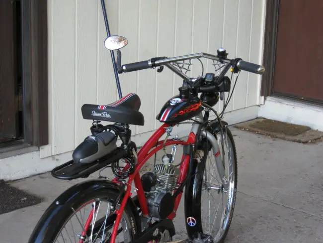

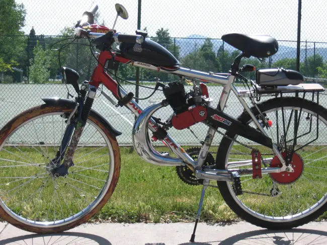

well the one you were looking at is a 80cc...35 mph...now my freind says put a big one on the 80cc and take the small one on the slant 50cc...pic included...i've built 3 bikes, my first a cruiser...steel frame but poor suspension...went to the mountain bikes one triple butted cromoly and one triple butted aluminum...i prefer these...now i,m in the process mentally to build everything from scratch and use alot of manic mechanic parts...but its time and money...and i'm in know hurry...i've got alot of parts...ha...thats something that happens....here is a few pics...keep everything tight and check everything after every ride...Dennis...the gary fisher cruises about 27...32 top end...lots of tork...the one above cruises at 30...36 top, but i believe it will go close to 40...their is no vibration in these two...i also use amisol sabre...80 to 1 which i bought from Pablo...that in itself will add about 3 mph...now in the one above i just added a pulse plug...30 bucks...low end tork...fast...i dont reccamend any of these things, i just like pushing the limit without to muc effort...ha...63 yrs old and going on 20...ha...if i can help let me know...

so you hooked up a 50cc exhaust on a 80cc motor? i guess theres not a big difference afterall... and that your other bike is 50cc and has an 80cc exhaust?
