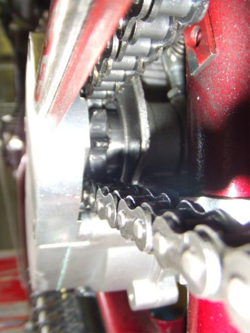

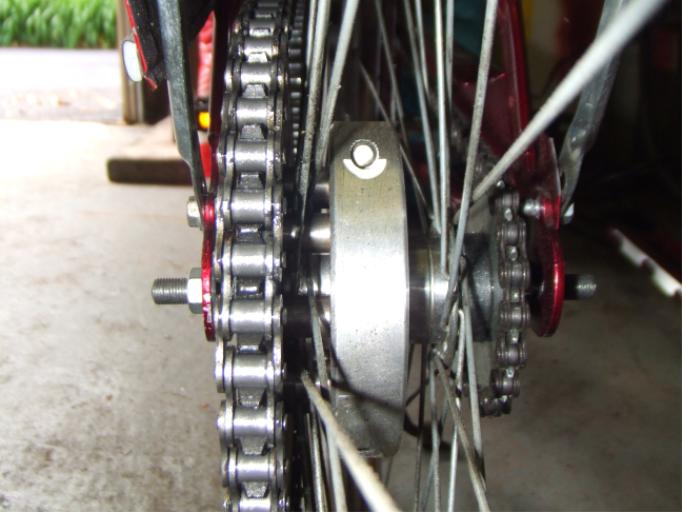

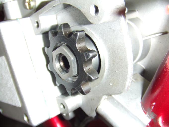

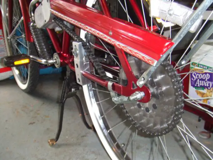

Finally got a chance to modify the sprockets and chain to a good quality #40 chain. It’s a tight fit but it can be done. Tight tolerances on the engine 10T sprocket and the rear I machined a clamshell hub and keep the nine hole pattern on rear sprocket of 45T. I’m into power not speed. The idler is a clamshell aluminum mount. Idler is uhmw with a one-inch roller bearing cam follower. The bear is being changed to a track roller bearing when it arrives. Will take better side-to-side pressure and it good to 1400 rpm. See attached pics.
It is like a whole new machine now. Vibrations are next to nothing now, no chain to sprocket noise. Just the chit chit bang bang of the exhaust now.

Very Good!!! Yodabob
The engine sprockets are scrap from the Chinese...I had planned on making several hundred of these, but if you are set to do it in volume...
I made the same type of chain tensioner for the Schwinn Jaguar...It worked perfect!
It is not necessary to utilize the 9 bolts when doing a clamshell. Next time try using (3) 3/8" bolts. It will be plenty strong and save on the machining time. I did a 9 pin for the Spoiler belt drive set-up out of necessity.

Jim, no mass quantity’s of parts here. We just whittle out what is needed on this old Bridgeport mill and an Enco lath. But we get-r-done. If you look close you will see I removed .100 deep chain track clearance path on your clutch actuator housing.
