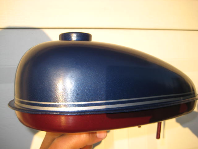

I love painting! SO far so good on this job, We're halfway through the clear coating process on this one and already its coming along.
Anyone have tips for wet sanding this tank? I have 1000, 1500, and 2000 grit paper and a sponge I can wrap them around, but what else do I need to know? I already have regular clear on it and plan to finish after sanding with some glitter clear. I don't know if I should sand that stuff but for now I'll assume no.
Pointers are welcome!

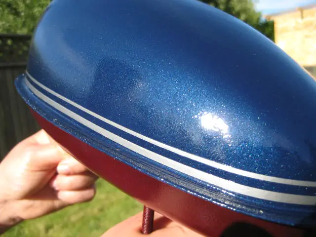

So we let the tank cure till 6pm, then wet sanded with 1500 then 2000 grit paper wrapped around a sponge to mellow out the pressure. Going lightly and using plenty of soapy water, it ended up going pretty good. The wet sanding process takes the clear coat and texture down a lot but leaves the clear coat filmy to say the least. At this point we took some turtle wax rubbing compound (seemed largely clay based to me) and rubbed and wiped and rubbed and wiped. The pic below is from about halfway through the rubbing compound treatment, and we got it a lot clearer before we were done today. Finally, and not yet pictured, we got the first two light coats of glitter clear on the tank which is now popping like the Fourth of July. I'll post some pics of it tomorrow after the paint drys and I have some good light to shoot it in. I may wet sand and rub it once more tomorrow before applying a final coat of glitter clear over the whole thing. All told, this tank had about 4 coats of primer, and 5 coats of color, and so far five coats of clear applied. All told there will still be one to two more clear coats applied when finished.
Thanks for looking at my project!

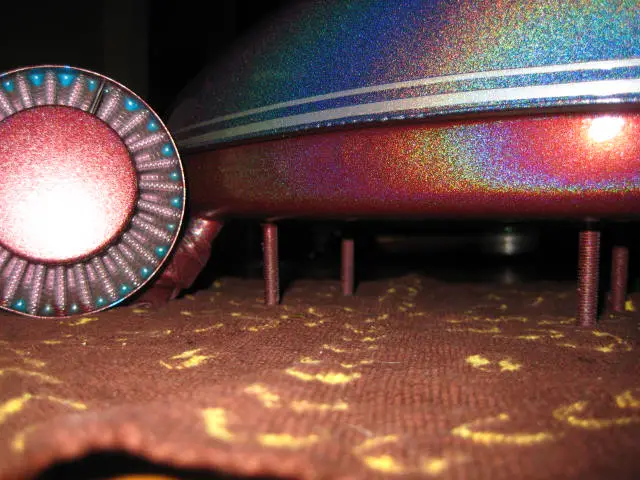

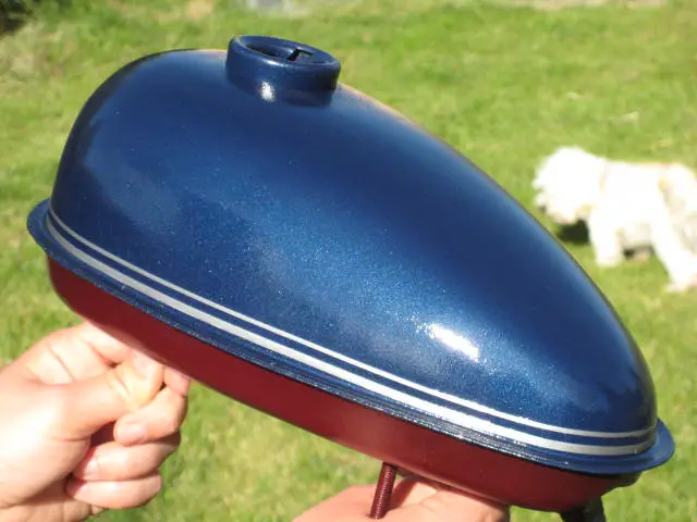

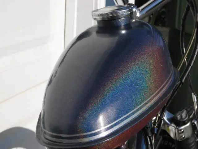

SO the final product is a little different than I originally anticipated, but I'm getting used to it now and I think it looks alright. At least no runs anywhere and it's smoother than anything I've ever painted up to this point. Let me know what you guys think!
