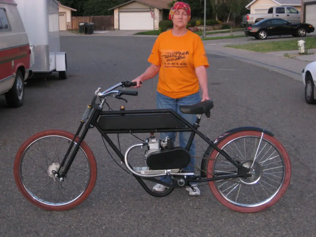

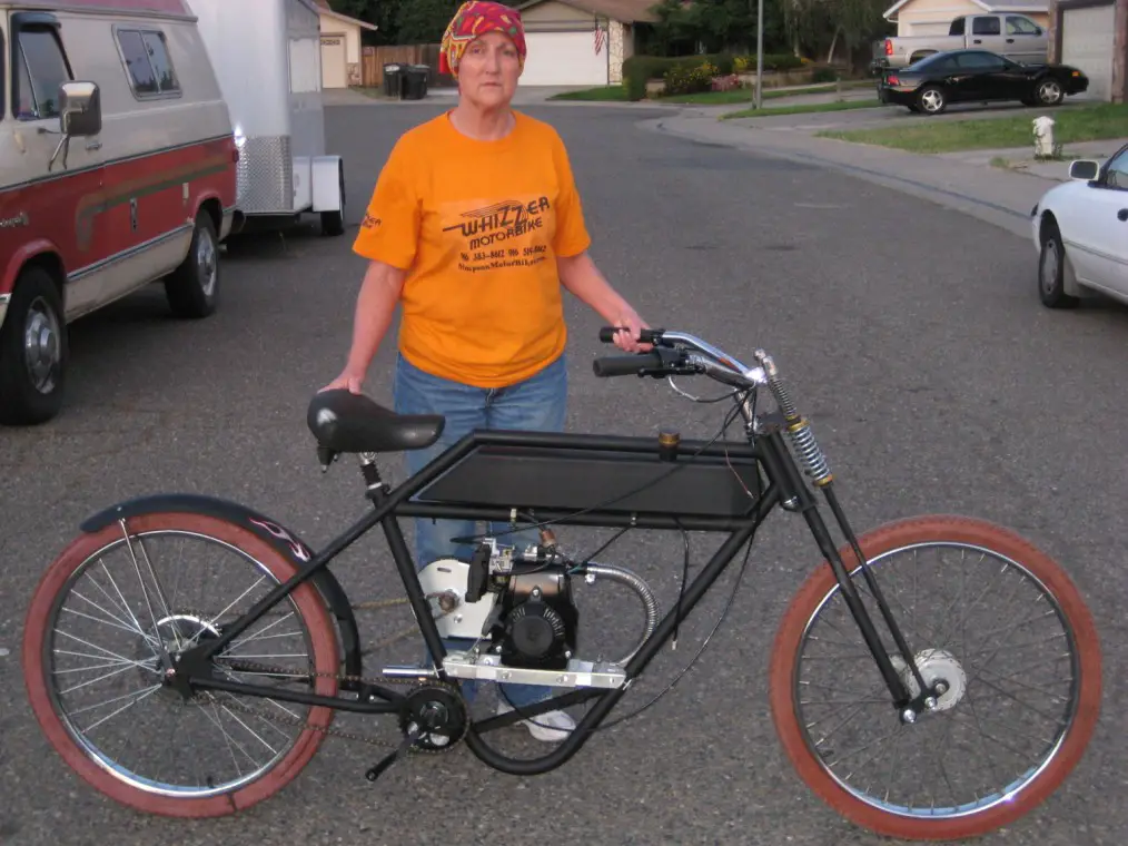

Hi Tag, I have had the pleasure of seeing a few real Board track racers up close, and I can tell you what clutch and gearbox the 8-valve Indian, Big Base 61 C.U. Excelsior, and a Harley with the Daytona type frame used.
Are you ready for this? NONE! They were chain-drive, no clutch, no brakes, no throttle control on most of them. Kill switch ONLY, started by pulling with a rope by another motorcycle or a car. The Harley I saw is raced frequently so they made a gas-engine powered starter, which rubs a go-kart type wheel up against the rear tire and then the rider jumps it off.
On my latest bike, built to ride on the streets of America, I used an EZ Motorbike Kit which works nicely on my 2 test bikes.
Mike
