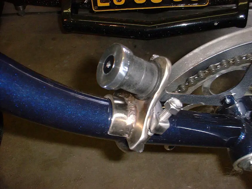

Here's the one I made for a Schwinn Jaguar.

Wow Tom, that's a really nice mount and clever too making the engine "post" of rubber to clamp too. Instead of the mount to frame area.
Junster,
Thanks, but what looks like rubber is in fact a very dense, (firm) polyurethane. There is little to no vibration absorption with it. It's actually meant for automotive suspension components.

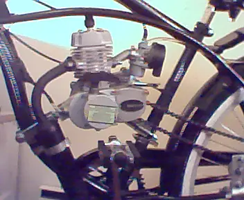

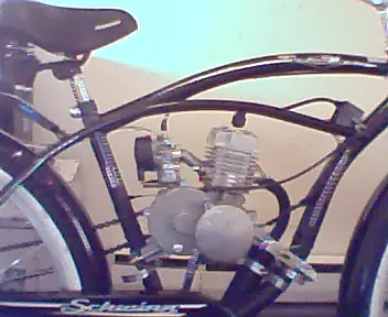

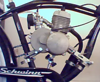

because i have a wide dual start engine i had to mount the engine real high.
i used two rear mounts on back and a metal bracket i had laying around for the front and a couple of clamps(no drilling).this is on a scwhinn delmar cruiser.with a regular engine it would have fit low with no clearance problems with the peddals.
