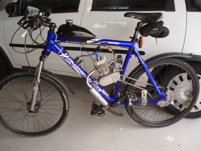

a picture of the bike will help a lot.

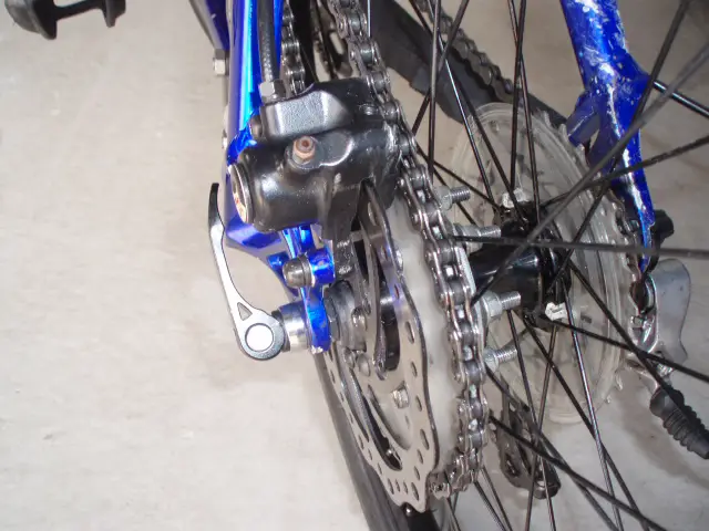

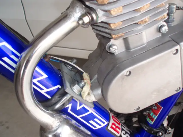

OK, here she is. I esspecially like how I made the rear disk brake work. I needed to pack out the disk and file off some of the caliper to get it away from the chain. Also have a very strong connection to the frame now. The new sprocket has made it very smooth and I have also glued a foam mouse pad over the clutch cover and stuffed some cork in the fins and that has made it very very quiet.

PS: Really liking that disc brake setup, good job man!
