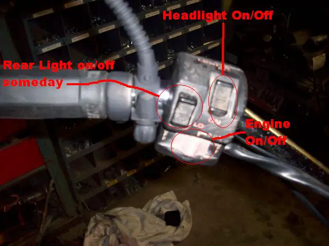

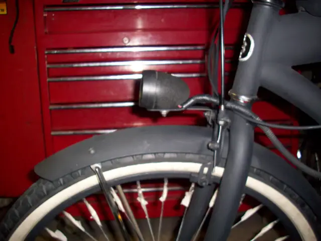

I use mine for the light and kill switch
http://motorbicycling.com/f23/lights-7306.html

The power wire for the light goes to the white wire
Ground for the light to frame
I use a atv kill switch so the lead for the switch goes to the white wire
then the switch has a ground that goes to the frame
When I want to shut the motor off with light on or off I just hit my kill switch..... simple and easy
