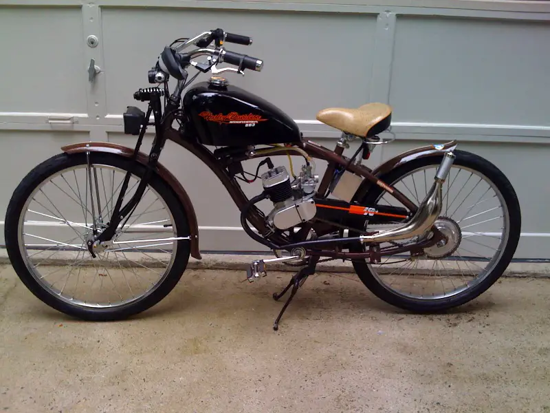

I've finally completed my bike so that I feel like it is ready to ride. It all
started out last November with just the basic bike and motor kit. What
I ended up with was this: Front and rear drum brakes laced with 12 gauge
spokes and motorcycle wheel bearings, Mikuni 18mm carb, 1986 Harley
Davidson Sportster2.2 gal. tank (E-Bay),12 volt 4.5 amp lead acid gel battery
mounted in a aluminum box, 12 volt 40 watt lawn tractor head light with 12v
LED tail light with brake light that works off of a 1972 Triumph/BSA front brake
cable with micro switch,Boost bottle, speedometer/odometer, tachometer with
time log. custom expansion chamber and custom chain tensioner wheel with 2
ball bearings. Top speed 41 mph (screaming at 7200 rpm) with a 41 tooth
sprocket. It will cruise comfortably around 35mph , which is fine with me.
I plan on installing a slant head on it next, to see how much if any improvement
shows. It's been more time consuming and more difficult than I thought it would
be. In fact I'd be a little embarrassed to admit how many days and hours I've
put into it. But, most of it has been fun though.

Jim, Yes, you are right. I forgot to add that I also have Creative Engineering's
clutch actuater kit. It's really the only RIGHT way to set up your clutch so that
it works smooth and easy, I love it! Thanks for the compliment too.

First thanks guys for the compliments I really appreciate them!
The 18mm Mikuni carb #VM18-144 comes with an 80 main jet, which is a little
on the rich side at top end, so I've got some various jet sizes above and below
the stock ones on order. I plan on using a 70 or 75 main jet. Currently I've located the 5 notch needle clip to the top, making it as lean as it can. It accelerates very
well and has rapid throttle response also. In order to mount the Mikuni, I had to
use a short piece of PVC tubing in order to reduce the spigot mounting inside
diameter, so that it would fit the intake manifold.That worked real well.I've been
trying to mount a UNI Filter to it, but so far I haven't gotten a good fit, so I'll
have to do some more mods to the filter and mount.

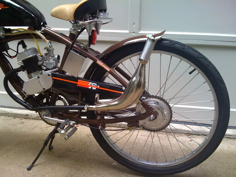

hi, i love your bike. it is AWSOME, but i see one little flaw. the exhuast pipe to the expansion chamber. i see a crumpled spot in it. i think it would decrease performance alittle and the long pipe that you have, might not have the desired effect that you might be looking for with the expansion chamber, but other then that it is still WICKED AWSOME!
Joe, I actually tried to mount the expansion chamber real closeto the engine, but the only route that might have worked was under the engine, and my center stand was in the way. I realize I could have used a side stand, but I chose not to do that. I was very curious how it would perform with the long pipe and the ex-chamber at the end, but it accelerates great and will hit 7200 rpm on my
digital tachometer. Keep in mind I opened and matched the ports and I can fine
tune the Mikuni carb til' the cows come home. The exhaust pipe does have a slight kink, but it's very slight. I had to heat the pipe cherry red to make it bend
and fit without binding. Yeah, I wish I could get that little kink out, but it would
be almost impossible to do without creating more problems. I certainly appreciate your observation and your compliments. It's definitely less than
perfect, but I can deal with it I guess.
