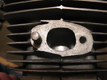

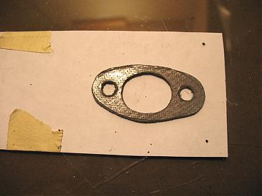

I have matched both intake and exhaust manifolds to match the ports. First I made a new gasket that perfectly matched the ports on the head. Then I used the gasket as a template to start grinding the intake and exhaust manifolds to match. Makes a big difference. I also got rid of any leftover welding that may be blocking the intake manifold where it makes its bend.

I did my exhaust port today. I couldnt believe how "off" it was. I mean the gasket and pipe covered at least 20% of the port on the head. Tomorrow its onto the intake....
