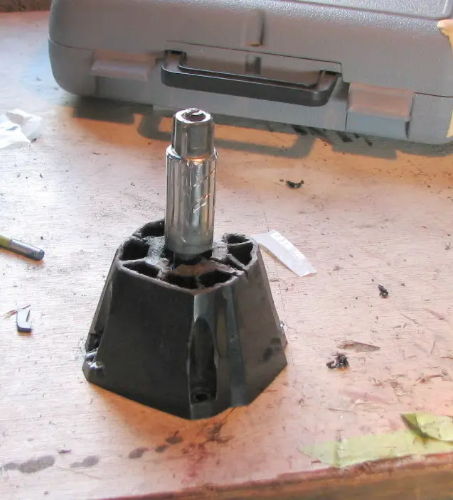

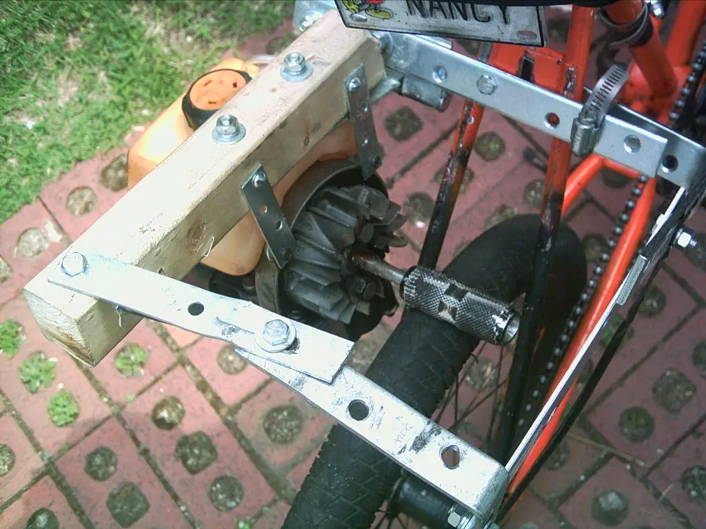

well it all depend specificaly what make and model of a chain saw you use. remember that the engine spins in the oposite direction than say a weed eater engine so you will have tio mount it on the right side of your bike if you were looking at it from behind. i am currently bulding a bike and am decideing what engine to use. i know that for the drive weal or spindal i want to use a peg from a bmx bike. im not so sure how to hook it up but its as simmple as a bolt some lock tight and if things get sketchy j.b weld is always a good thing to have around.
