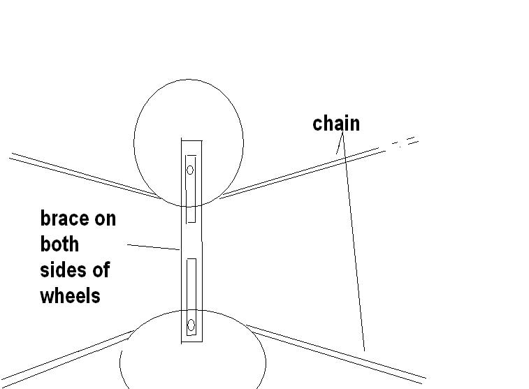

with two wheels and a brace on each side of the wheels would probably work.
Name:	chain tensioner.JPG
