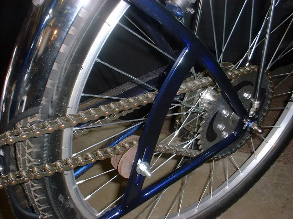

I've attached a picture showing what I did to eliminate the clamp-on tensioner bracket. Hope this helps. It also shows the skateboard wheel used in place of the kit supplied pulley.
Nice Tom, I missed that in your original build photos.
