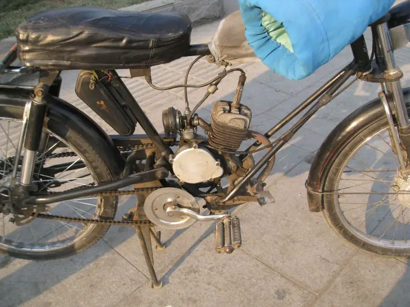

Well... One could look at changing the appearance of the Chinese motor. I've thought about this quite a bit. I think the biggest change I would like to make is altering the appearance of the clutch cover, and the magneto/clutch arm covers. I've toyed with using paints to do this, I think drab military colors would age the motor, and I've thought about having faux covers made. A sheet metal worker could really knock off some vintage style "cover-ups".

Of course with time the china motor can look like this:
