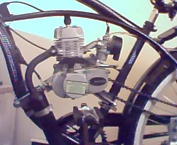

my engine: gasbike 48cc dualstart dualclutch starfire gt2 grubee w/44t sprocket $188
engine has cent and man clutch,35mph / 180-200mpg
my bike: Schwinn Del Mar from walmart $99

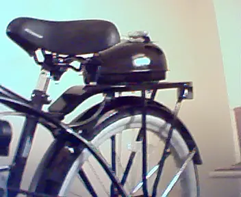

fuel tank is mounted on rear rack and has new rubber gas cap/plug and vent

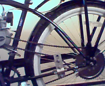

dustcap removed from rear wheel so sprocket will fit
spacer put on rear sprocket and fender notched out so chain will clear tire
new 5" shorty crank arms and solid rubber peddals/no reflectors

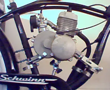

engine mounts:
i used 2 rear mounts on rear and custom front metal bracket clamped on
bike and engine runs great.

i will be using this tank for a while.
i did put 2 black saddle baskets on the sides of the rear rack.
and i now have very bright 12v head and tail lights with rechargable battery.
