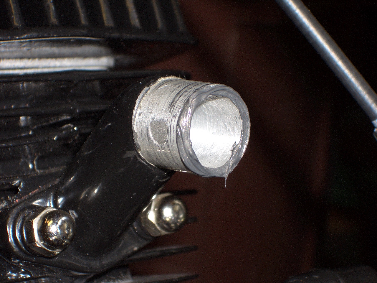

4. I don’t think I had any air leaks to speak of, but I sealed the carburetor onto the intake manifold by putting a little gasket paste from a tube onto the flat round end of the manifold (see photo) before finally installing the carburetor – just in case. That’s the only place I could see where there might be a leak.
