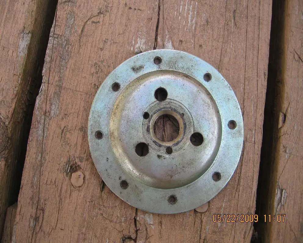

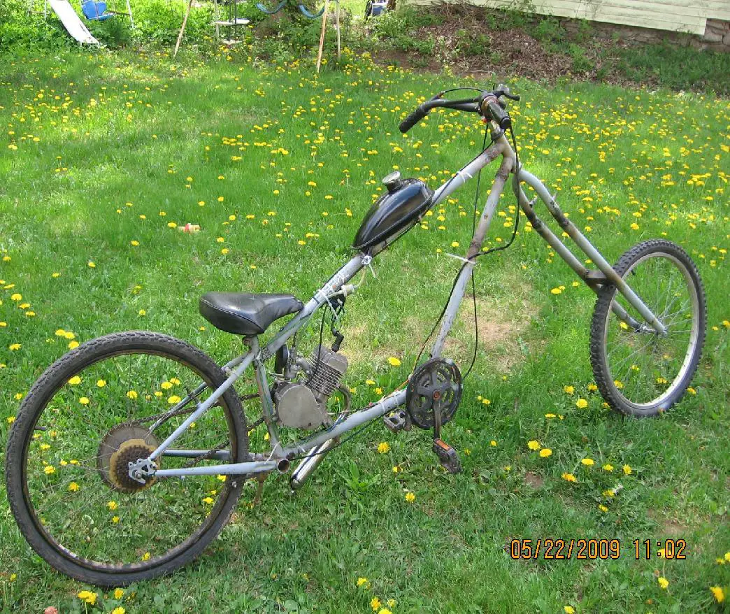

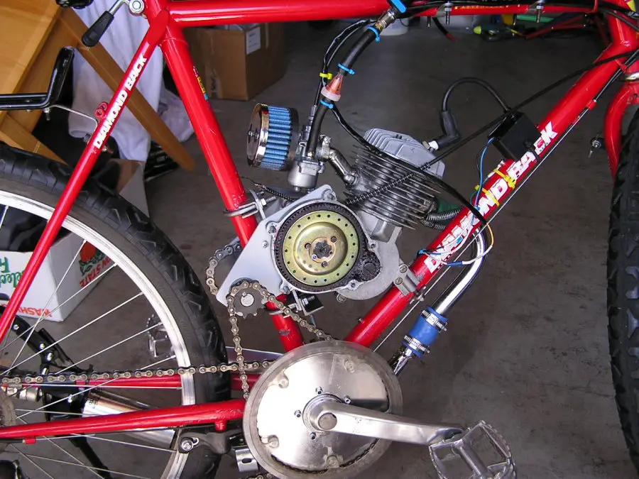

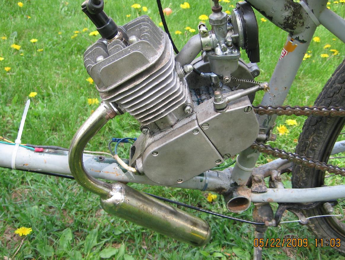

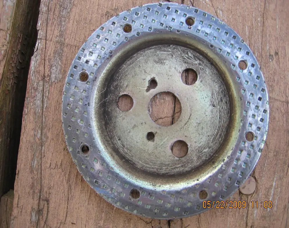

i posted before that i had made a clutch mod that helps with engaging and disingaging, it also help with cooling and wear on the pads. so here it is.And heres a pic on my custom chopper, forgive the cruddy appearence, its a work is progress.

I drilled many more holes than that. Works well, I must admit. Also you should degrease yours and scuff it with a flat file.

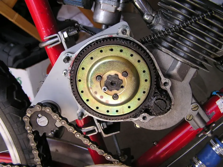

Weird - I posted pictures in this thread before (or so I thought!).
Here's my drilled clutch plate set-up:

that will work too. i just did the 8 holes on mine just for experimental purposes, since it was a success i may drill some more, but it works, that good for me.

Either way seems to give good grip....I just can seem to dial my adjustment in.

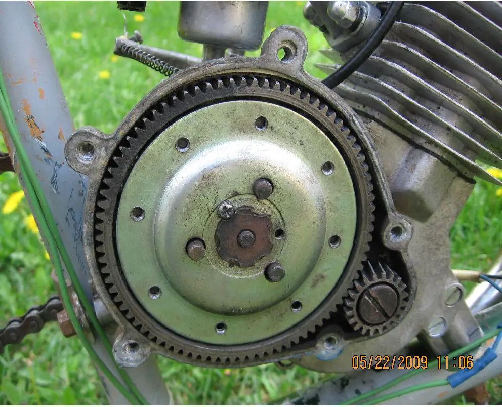

why cant you? i have no trouble with mine at all? do u have the stock clutch? mine stock and i have no trouble adjusting it at all.

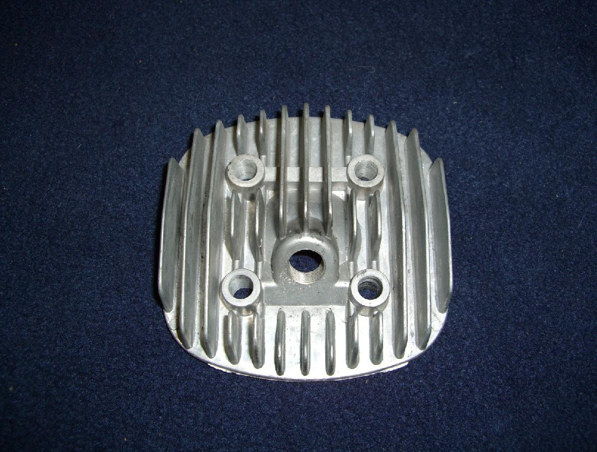

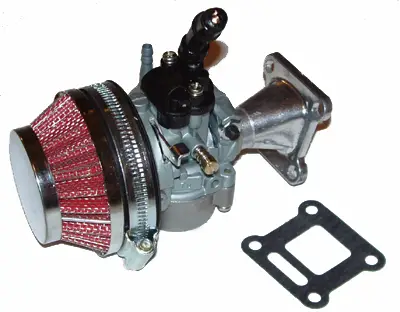

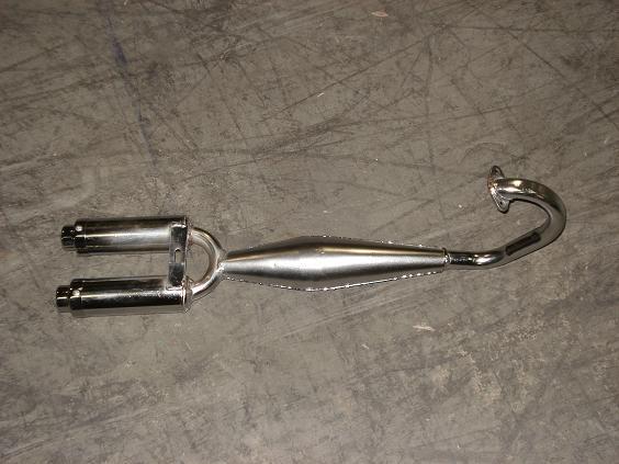

okay so i got some extra money and was looking around ebay and found this. The carb and pipe are resonably priced so i think i will get them, i already have a pipe, but i think ill get this pipe cause i looks kool, the carb is better priced then the one i found in town so ill get it. also i sent in an order for my own slant head for the 80cc, i also odered an extra head gasket and cylinder bae gasket just in case. ill get pics when i have the bike all together. oh the pipe is $35 with S/H the carb $46 with S/H as well. my pipe was $40 and the carb this guy has in town is $50 without the filter so i though id go ahead and get these, might as well save as much money as i can. and some might know the head cost $23 so that a given. all in all $130 well spent if it gives me the perfomance im looking for.
