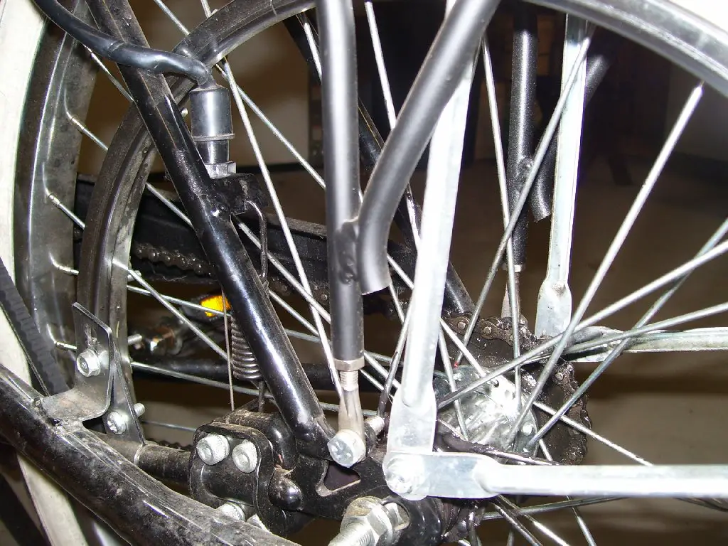

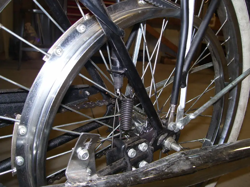

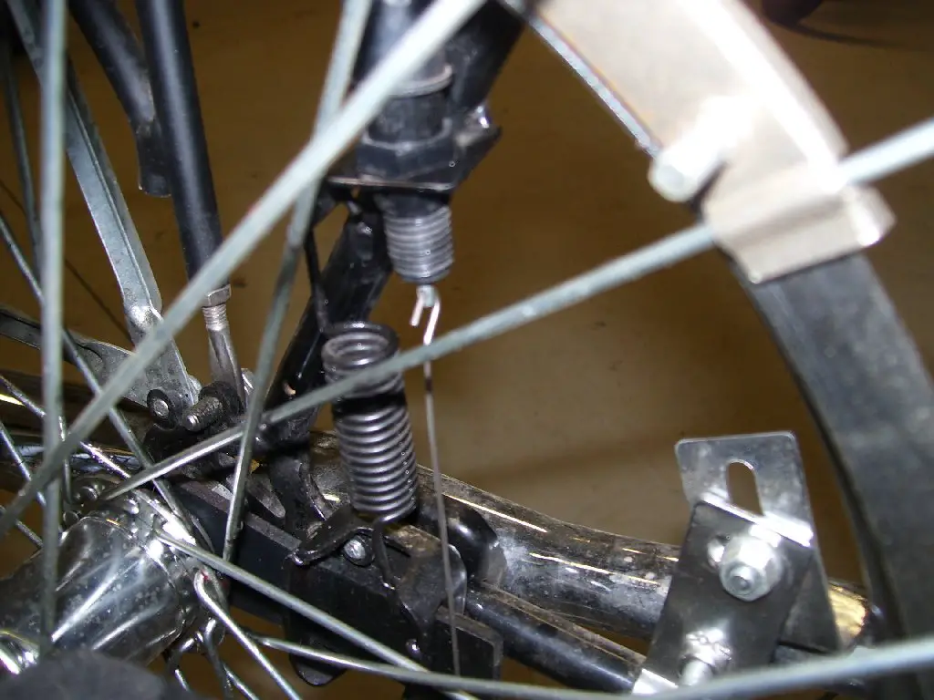

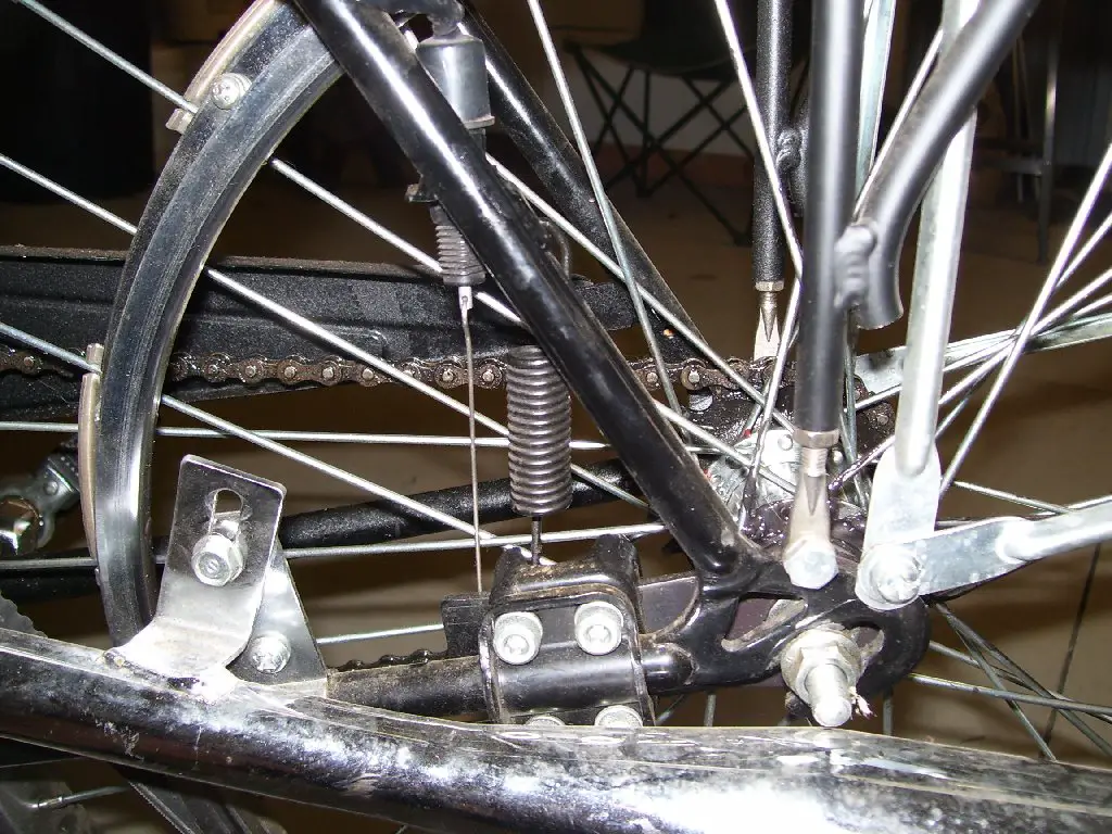

Anyone have a picture of how the Whizzer coaster brake light switch is set up? I just can't get my mind wrapped around how a switch is connected to the coaster brake arm. I'd like to set something like that up on my bike.

Here are some pics of the rear brake light switch.. Hope they're clear enough to see. It's easier though to just buy a front brake lever with the switch built in if you have a front brake.

Thanks jbcrusin I think I can fab up something like that.
