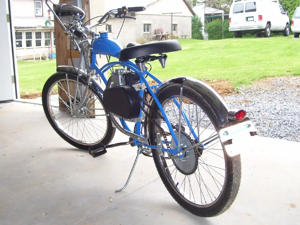

I have an EZ kit on my bike & love it. I'm listed as a dealer on their website. Here's a pic.

Old 06-15-2009, 11:45 PM
Nashville Kat's Avatar
Join Date: Apr 2009
Location: Jacksonville, Florida
Posts: 907
Default Re: 1st project. Which engine?
The bike looks great, but where do you put your feet?
How many gears and what'll she do now?

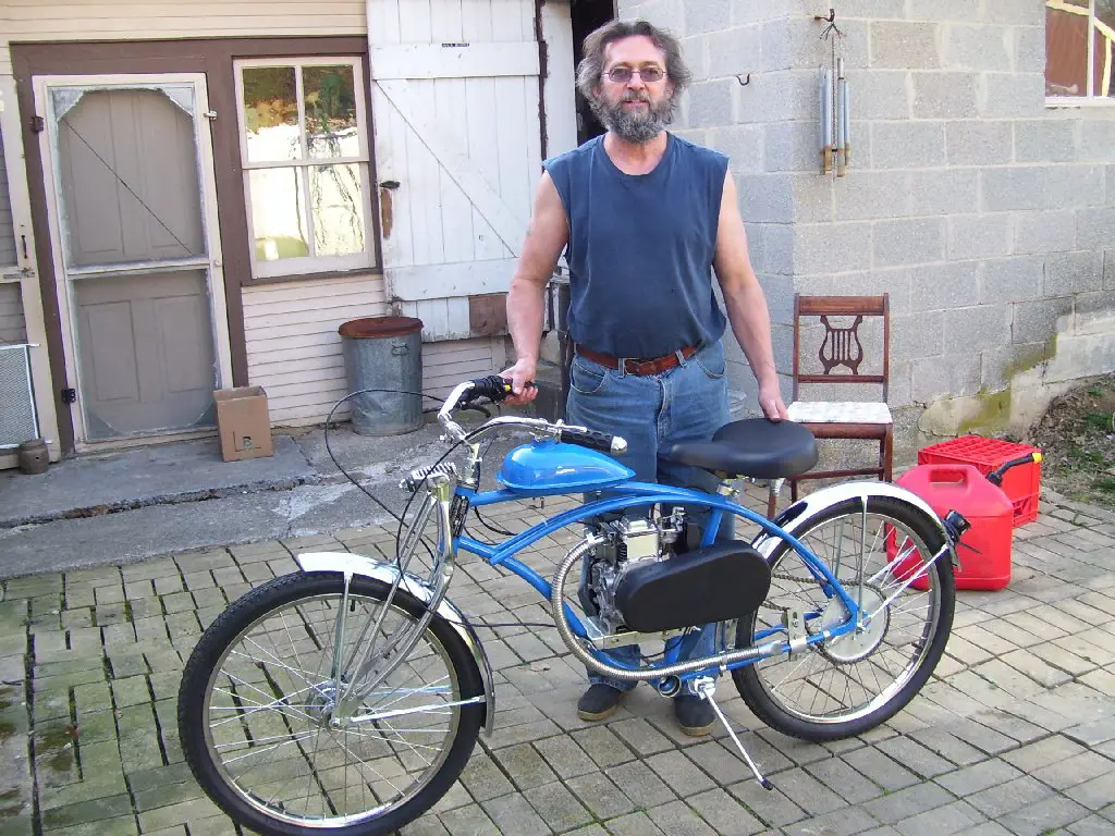

I didn't have the crank & pedals on yet in that picture. Here's one with everything.
Jay
