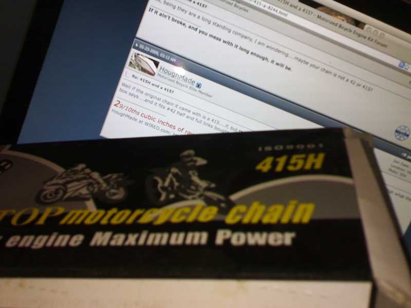

So... I ordered a 415H chain the other day and tried to fit it in half an hour ago. It required some force with the rubber hammer for the chain to follow thru with the engine sprocket. Havent moved my bike yet but what do you say? It feels like the chain will eat some of my block away, even though it may be 0.5 mm of material.
Are you sure this is the right stuff? (see pic)
