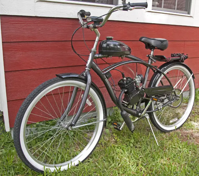

my uncle has a Del Mar with a black 80cc mounted and it looks good. I'll get a pic tomorrow for you. You will have to notch the rear fender and also make a front mount for the engine since it's got a large down tube. I can tell you that the bike rides really nice. I like it more than my Huffy Cranbrook.

Here is a pic of my uncle's Del Mar with the black 80cc on it. I think it looks sharp.

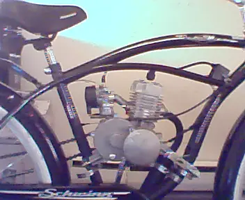

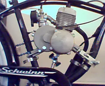

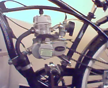

i have my engine installed on my delmar.
its mounted real high with custom mounts.
the stock muffler fits the bike.
i had to adjust the chain and tensioner a few times and now its good
i notched the fender and i have a spacer on the rear sprocket and removed the dust cover.
my fuel tank is mounted on rear rack.
i changed my sparkplug.
my engine is wide with dualstart pull or peddal and is dual clutch too.

heres some pics:
ive mounted some black side rear baskets and i will mount some lights soon.(not shown in pics)
