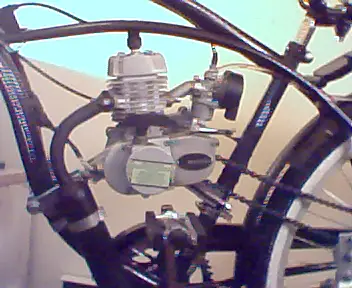

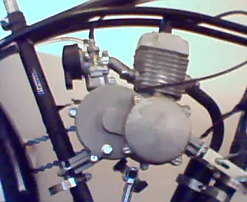

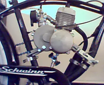

i too had to mount my engine higher,i used 2 rear mounts and a metal bracket for the front that i had laying around. my peddals clear my wide dualstart engine with dual clutches.
my stock muffler also clears the frame and peddals. the bike is a schwinn del mar cruiser.
