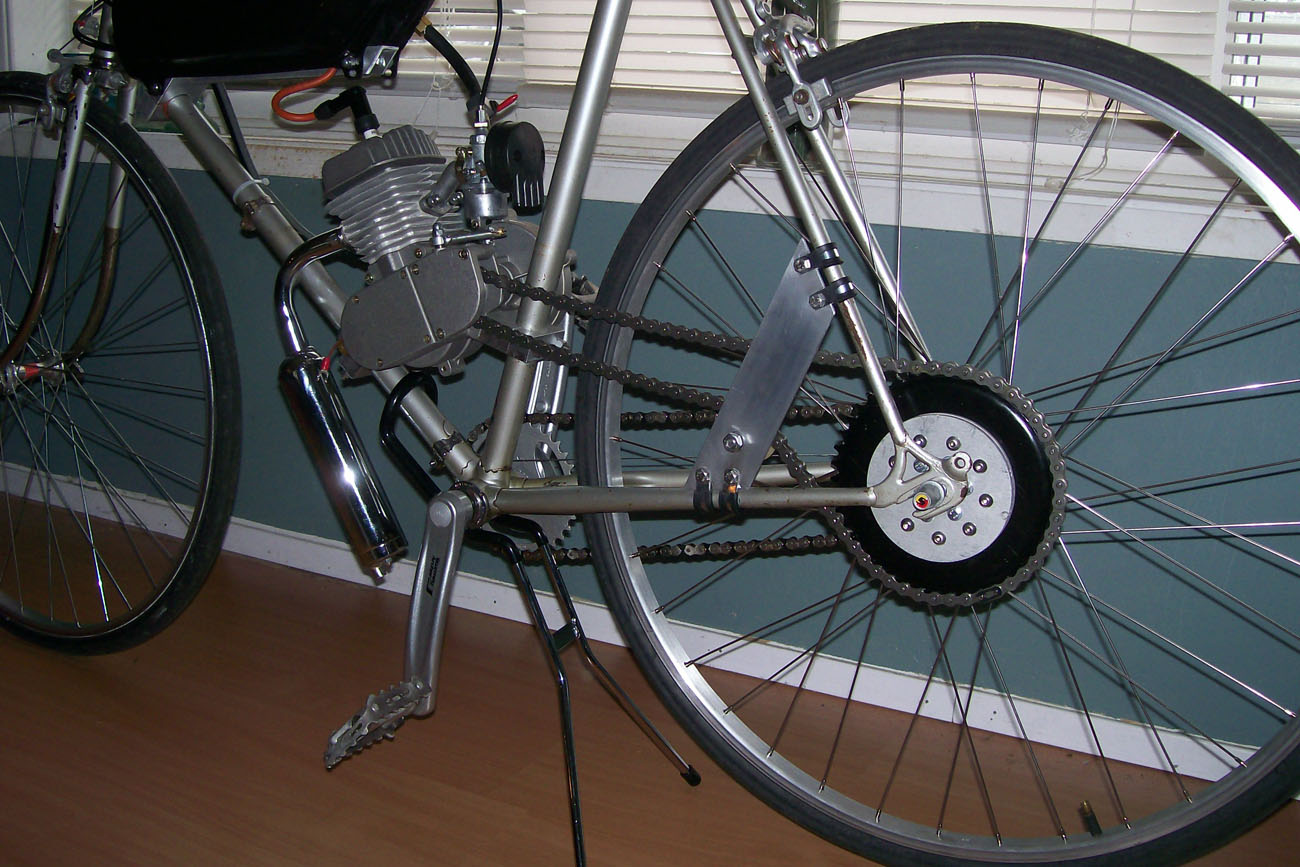

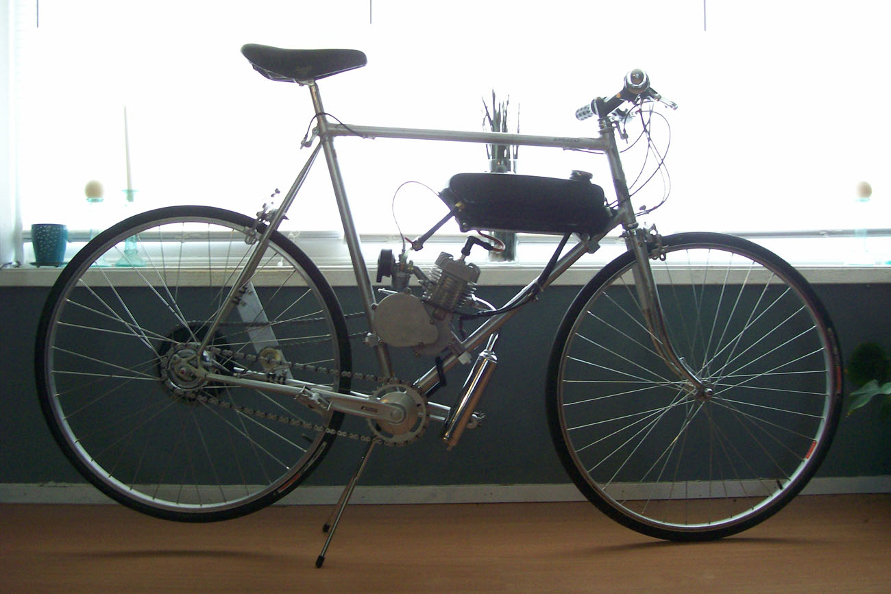

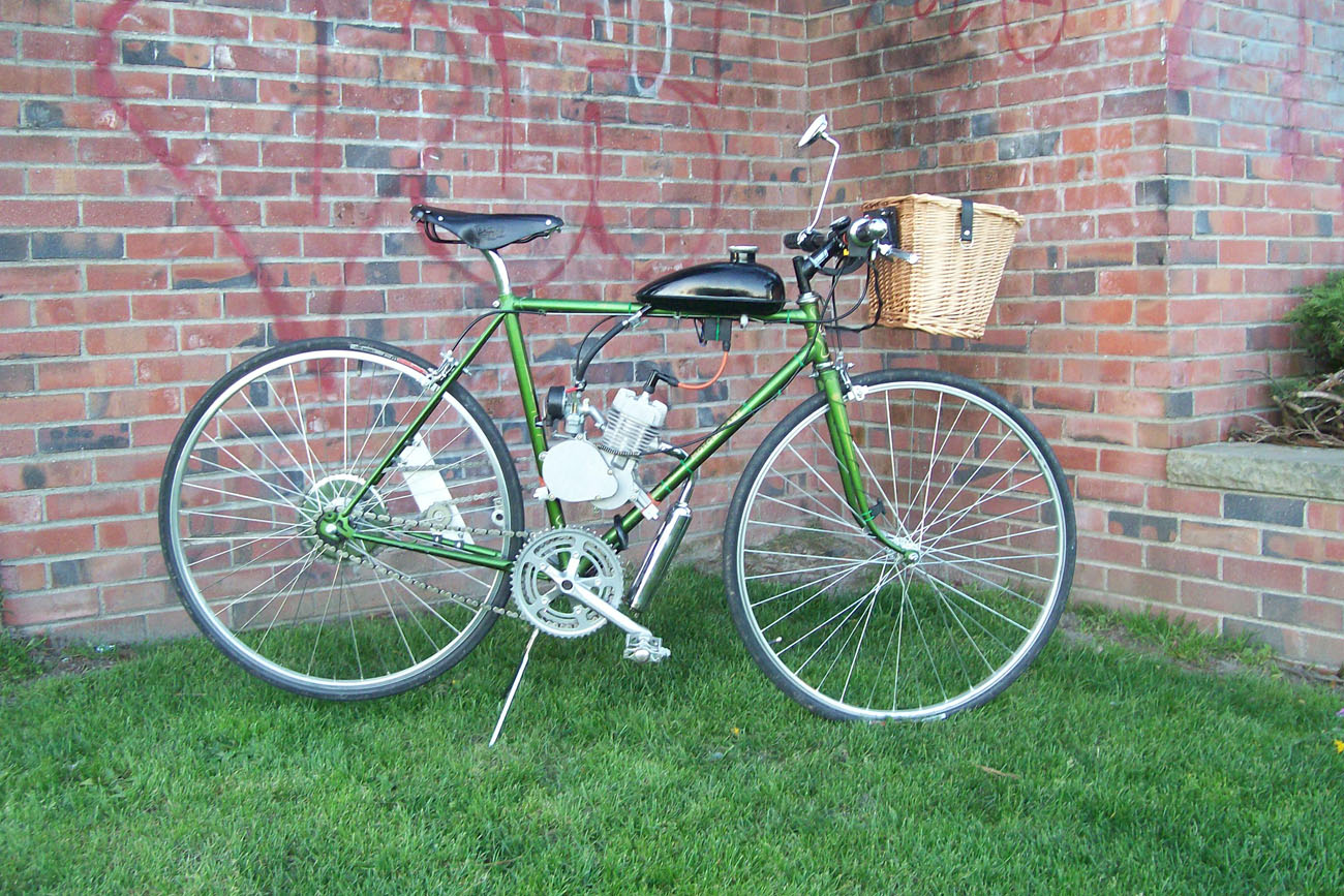

The last option, for a road bike, that I would consider is using a rubber donut mt that comes w/ the kit. Use a disc mt or mb specific hub, preferably disc mt. I attached a few pics of road bikes I've built. I hope this helps!
