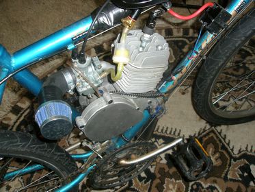

Thank for the reply and confirming my "suspects" fairracing31;
1:Engine mounts are fine
3: there is no filter inside the tank, it has an after market brass tap and inline filter.
6: All brand new, I don't think there is any gunk, but I'll check when checking bowl level.
Could be 2,4 and 5

I have posted a pic to show the setup
Name:	tn_ZBox New Carby on 70cc Huffy Frame.jpg
