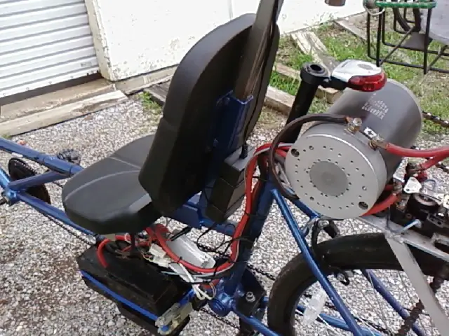

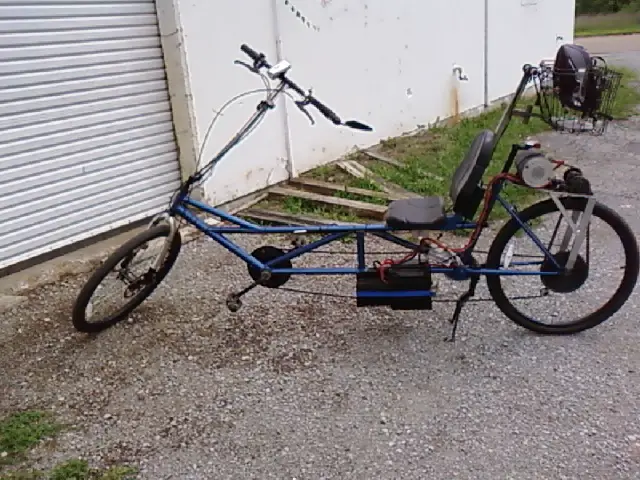

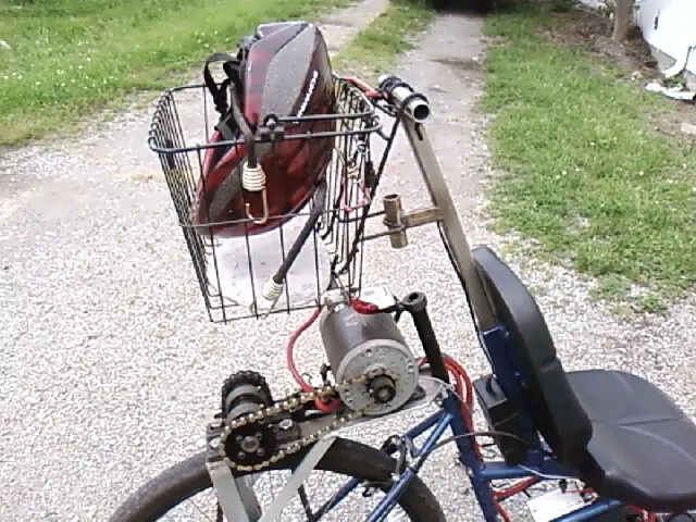

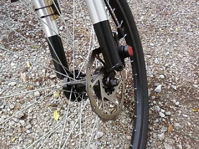

Hi
here are som pics of my bike. It has an 84" wheel base, will run 30 mph on flat ground and has about a 12 mile range in the hilly terrain here in S.E. TN. It was built from a walmart mountain bike 14ga 1 1/4 tubing and some junk bike parts. The frame for the cargo basket is made from stainless and slips into the tube for the seat back, it can be removed in seconds wthout tools.The bike has a 36V battery pack and an onboard charger, also I have adapted a disc brake to the front wheel.
Jim

looks like a nice bike to me, and I think you might have discovered a good method to DIY an ebike. Start with someone else's and work from there. I like the idea of just using the wheel from an existing ebike. That is what you did isn't it? If not it sure gives me an idea.

thanks for the comments. To answer your question about the wheel no ebike parts used, the walmart bike was just the cheap $50 dollar mountain bike. I fabricated pretty much everything on this bike even the drive sprockets( I own a machine shop).
Jim

Hi Ozzy,
I built this bike to be pretty much a pedal assisted electric.
There is quite a bit of drag from the motor when pedaling alone, you sure wouldn't want to pedal it too far. In an emergency it would be fairly easy to pop the master link off the drive chain to eliminate the motor drag. This bike has been a test mule for different ideas and I have a more powerful motor that has a freewheel on the drive sprocket I just haven't gotten around to reworking the drivetrain setup.
Jim
