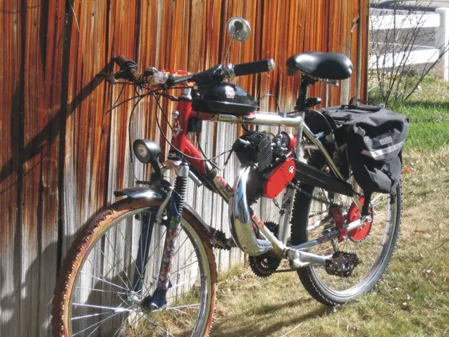

it will fit...but the mounts could be tricky...think it out good first...try a 80 slant from zoombicyles...that will give you more room...i have a 50 slant from boy go fast...its turned into a fine rid...with expansion chamber from spooky tooth...you might be able to incorporate a gas tank in it...check the winter build...china bike...last entry has a felt with a tank incorporated...if you get it ...let us know how it goes...Dennis
It will fit, I built a Macargi similar to it. The front down tube is approx. 1 1/2". You will have to figure out a mount for it. A U clamp through a flat plate bolted to the motor holes will probably work the best. You won't have to drill holes in your frame that way.
