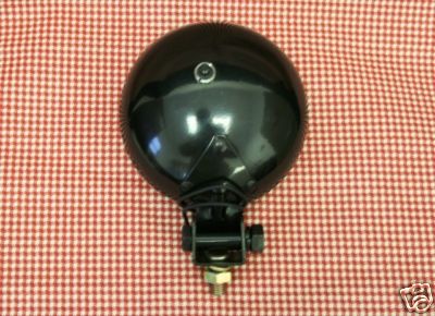

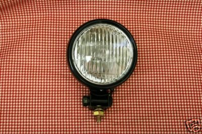

Hello fellow MB'rs
ive just oreded a 6v tractor headlight, to hook up to the white wire.
first i was thinking of just hooking it up direct and pray. But today i was thinking of buying some kind of regulator...that way when i accelerate the volts dont burn my light.
went to Radio Shack and found this little volt regulators, that have input ground output...but they are either 5v or 12v .....i cant find a 6v one, could this little things really regulate my white wire?
has any of you tried this?

no I haven't. My guess is your light will either kill your engine or be very dim.
Norman
do mean that if i put a 5v regulator it would die or be dim? would you say i could get better results putting it raw on the white wire?
and Norman, thanx for you replys, they enlighten my experience.
