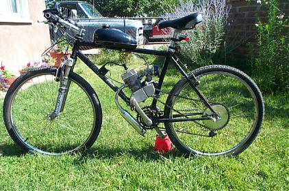

Just found this website today and wanted to join with you guys. I have a 1995 Diamond Back Mountain bike with an 80cc Chinese 2 stoke kit. I have done some mods to the set up: Free flow air cleaner cover, Re-jetted the carb for 5200 ft above sea level, Boost Bottle installed and cut down the tube in the exhaust. Anxious to read about any engine mods here and see what others have done.

Thanks everyone for the warm welcome. I have had my motorized bike for about 2 and a half years now and have put nearly 900 miles on it. I guess the gearhead in me always wants more power so that fueled the mods that I did to the bike already.

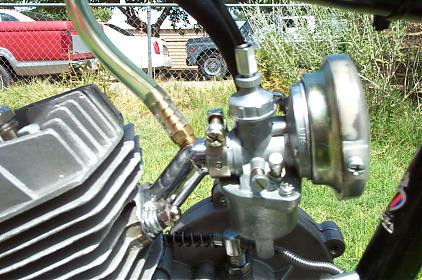

Here at 5200 feet above sealevel you have to get creative with your jetting especially on a 2 stroke so I did some internet research and read about a guy who soldered his jet closed and re-drilled it to make it the size he needed. After reading that I was so excited to try it because my motor was jetted for somewhere around sealevel (China ) and it just didn't run very good up here. I tried to find some aftermarket jets with no luck. This prompted me to try the re-drill approach and what do you know it works. Since I re-jetted my bike I have re-jetted 2 other bikes at this altitude and it works very good on them all.
I have some other mods I mentioned, but I will search the site and try to find a thread with those mods to match it up. Glad to be here and look forward to see and read what the members here have done to their bikes.
